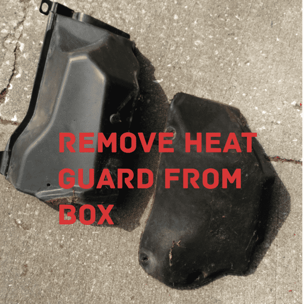

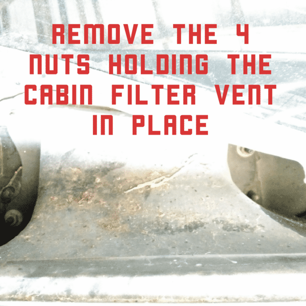

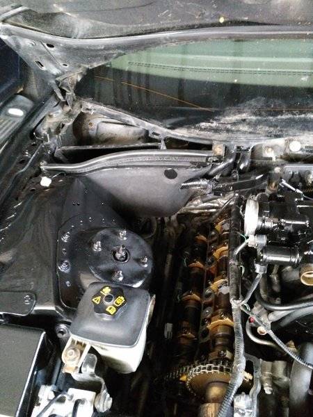

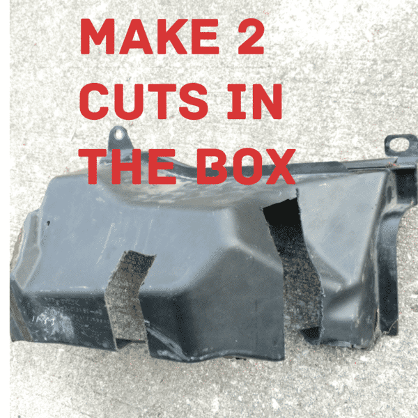

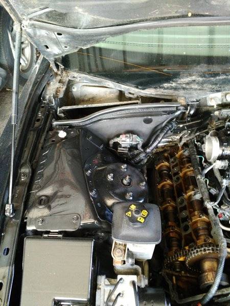

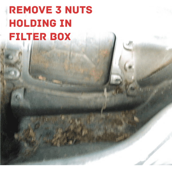

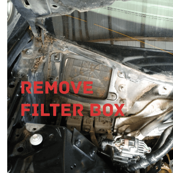

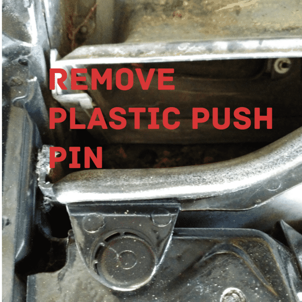

Ok maybe its just me but, I get super annoyed by engine clutter, excess wire, vacuum lines etc.... Anyway i tucked a group of wires today which in my mind changed A LOT!
What you'll need
1/4 drive ratchet
Extensions
Swivels
11mm deep well socket
Dremel or jig saw with a fine tooth blade
Razor knife
You can see the rest of my buil here
My $300 LS build
Before
Nice work. A full tuck is one of my long-term goals for my LS once I can commit to it not being my Daily. ( i have a tuck/shaved bay on my last project) Would look great done right in an LS bay. It has the potential to be a really simple engine bay if you are willing to do a lot of relocating and possibly some deletes.
