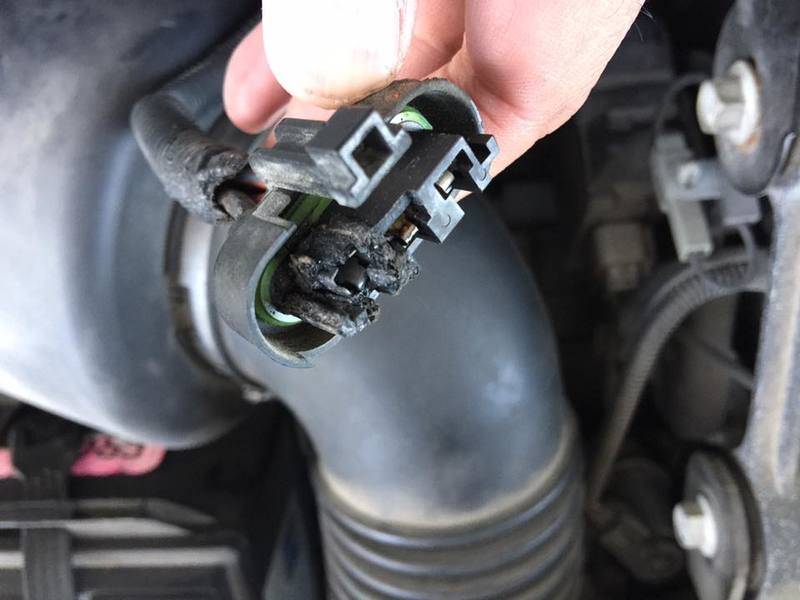

here's the result, one of the fan motor locked up and fried the connector. I tried manually rotating one of the fan and it's locked up real hard. The other one is freewheeling smooth. Time for a new set of fan.. and a reminder with this car so old a drive through on a hot day is not a good thing to do..
Wow that is scorched. Post the brand you get, I'll keep a look out on your facebook page.

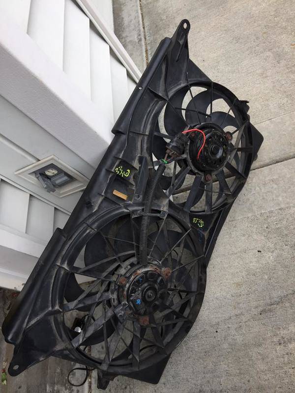

I just bought a junkyard replacement, test it out and works fine. Compared with other cars where you simply pull out a couple screws and pull the fan assembly out, the Continental is a real bitch to work with. The whole radiator must be removed along with the fan. I tried removing the fan by itself in the junkyard and wasn't able to do so.
Nice score for sure. I read up on the fan removal procedure myself, like you said its a pita.
Hopefully you won't run into any other problems.
Wonder why they didn't use the Mark fan assembly. Wouldn't be surprised if you could shoe-horn two of them in for half the headache....
