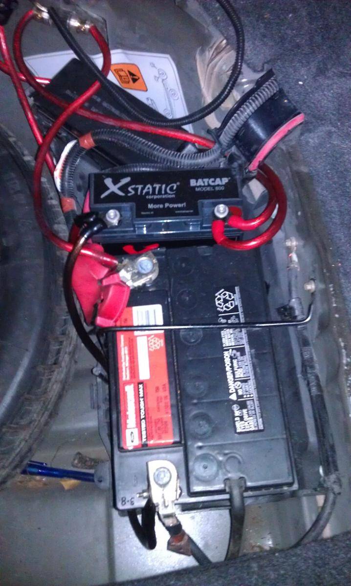

This is how I did mine and it worked very well.
that's a batcap (a cross between a battery and capactor), not a capacitor. capacitors don't fix an overloaded source, it does stabilizes the voltage but fails when the system is at full load, it's useless actually and your system will work fine without it.
In my LS..I have a (2) amp setup..one amp is a four channel for the doors (have JL customs tweeters cut into the doors matched with JBL door speakers) and one amp is for a JL W12..there is a lot of high voltage running between these amps and without a capacitor..I had all kinds of power drains, lights dimming, etc. The HO alternator wreaks havoc and will not work on this LS (2000). The only stable way that I have discovered is using the capacitor. My Clarion ESQ equalizer bears most of the work, next to the 7" navi. With the capacitor my amps don't cut out and shut down..and there is a sufficient reserve voltage to power my system and the other electrical demands coming from the rest of the car. If you insufficiently power a extensive system in this car, fuses will begin to blow and all kinds of crazy electrical issues will occur...
