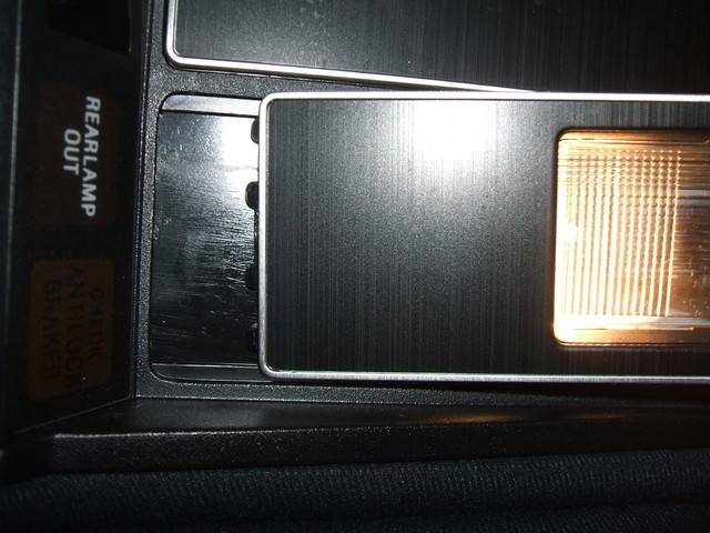

how the heck do i get at that check suspension bulb in the overhead console? I see no screws so I assume it's a matter of carefully prying...but where?
http://thelincolnmarkviiclub.org/documents/tech/overheadConsole.pdf

Thanks for the article on removing the overhead console - very helpful.
