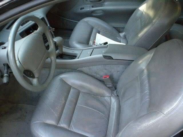

Mines getting all cracked and :q:q:q:qty looking.
Notice I don't have an embroidered lincoln emblem on mine... Are there any cars that are a direct replacement for the leather covers? Or do I have to go and find another Mk8 with a gray interior?
93's didn't have the embroidered logo...
Pretty much going to need to stick with Mark VIII covers if you want a direct swap... but why not go grab a cover of a Town Car or Conti and open up a new possibility for us!
Hum - not a bad idea. I'll check around and see what i can get...
go get a back seat from a 93-94 with the same opal gray interior as yours and have an upholstery shop use the rear seat skin to repair your front seats, its a dead match and will already be broken in so it wont look half brand new and half worn in. i sell rear skins all the time to do this exact thing.
