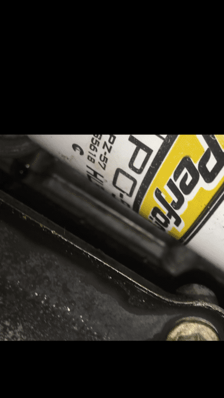

Hey guys I'm looking for some help. I have an 05 V8 with 168k on it and leaking oil pretty bad. Bunches of small puddles everywhere I park, almost seems like it's mixed with coolant but I did just have the water pump replaced. There's always fresh oil on the pan and it looks like it trickles down from above. Looks like it's leaking from the timing cover...could this be possible? Also I have a pretty rough idle so if it ends up being the timing cover gasket I may end up replacing all the chains/tensioners. I have attached a picture of where it's coming from, which is hard to see but seems to be coming from one of the bolt holes at the bottom of the timing cover. Any feedback would be greatly appreciated.

Yes, it could well be the timing cover gasket leaking. The one on my 04 is leaking (but a very minor amount), and I have talked with another LS owner that had to replace the timing cover gasket on his 2nd gen.

Did you for sure chase the oil leak down? There is a product called LA's Awesome Degreaser you can buy for a buck a gallon at most dollar stores....I'd spray the pan with degreaser and clean it up really good so to see where it's leaking for sure then go from there...
Yeah I sprayed it all down with brake cleaner and it started from above the oil pan but I figure I might just replace the oil pan gasket and oil filter gasket and see if that might narrow it down or not
