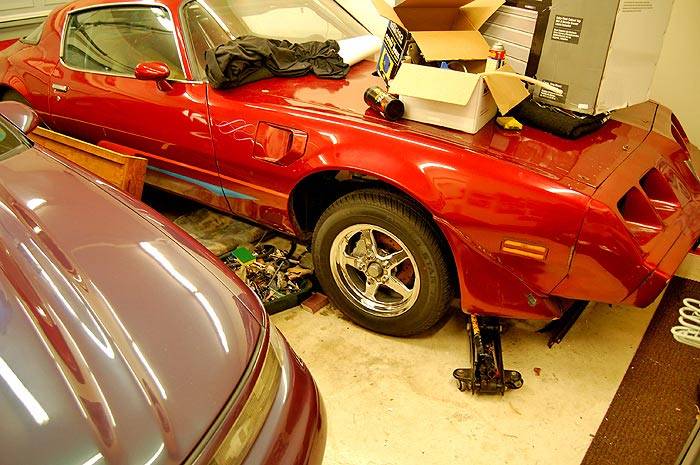

Run these in 17x4.5's, they are bada$$ dont go with the MEGA played out "standard" Weld line of Draglites or Prostars. I have these on my T/A and they look saweeeeet as hell. Look like the ultra expensive Weld AlumaStars.
how much do they weigh? What size are those? 15x? I only see 15 and 20" on that site, and I don't see a price on the 15X8 do they not come in that size?
I still need to figure out what needs to be done to fit a 15" wheel on the front of a Mark VIII...
Yes they come in that size, you can also get 17 inch skinnies and meats with no worries of anything hitting and no hub swap. I have 15x16 rear and 15x5.5 in the front.

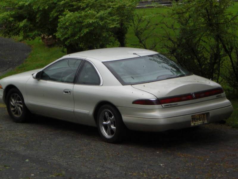

Thanks for the info. I still like the look of a 15" wheel. something similar to this:
This car would be perfect if it was like 1" lower, or slightly bigger tires in the rear.

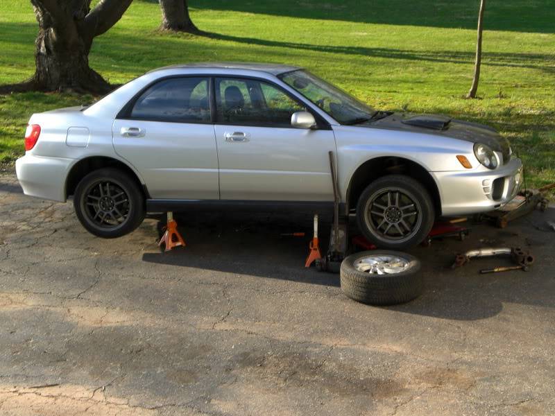

I have rims that aren't even that light on my WRX and I have bent em all hitting holes I didn't see. That is on a car that is about 600 or 700 pounds lighter too!

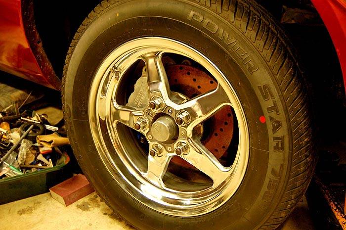

ONEBADMK8, there are not a lot of pictures of 15" wheels to show as an example, so I have to take what I can get. :) Definitely don't need tires that skinny up front, but I wonder how skinny I would need to clear the rotors...
With my WRX I had 17" Konig Glides with 245/45 tires on em. So it ain't like I had some O ring tires on it. Matter of fact I have 2 of those same tires on the back on my Mark right now.
They hook rather well at E-town but the rims are steel so they are heavy. Plus they give me a lot of room for big brakes on the Mark. When I did the big brake swap on the WRX it made all the difference in the world on a car that had good brake in the first place!
I can't find a close up pic of the brakes but you can see how big they are in the front rims from this view. There 14.5" in the fronts and 12.5's in the back if I remember correctly?
