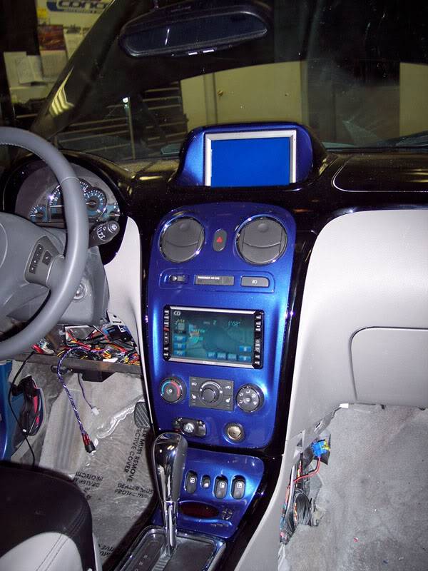

My car is an 04. Here is another dash i did for an upcoming episode of Rides on TLC. The car is an Chevy HHR. I filled the oversized radio opening and put the eclipse in then made the bezel around the ac stuff all one smooth piece. The i took the flip open lid on the top of the dash and made it into a housing for another screen.
