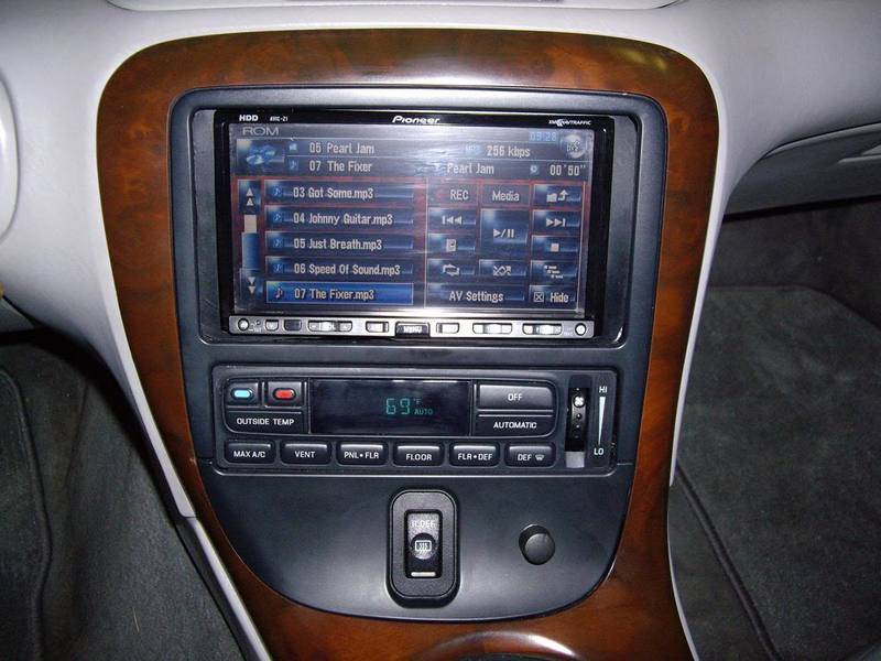

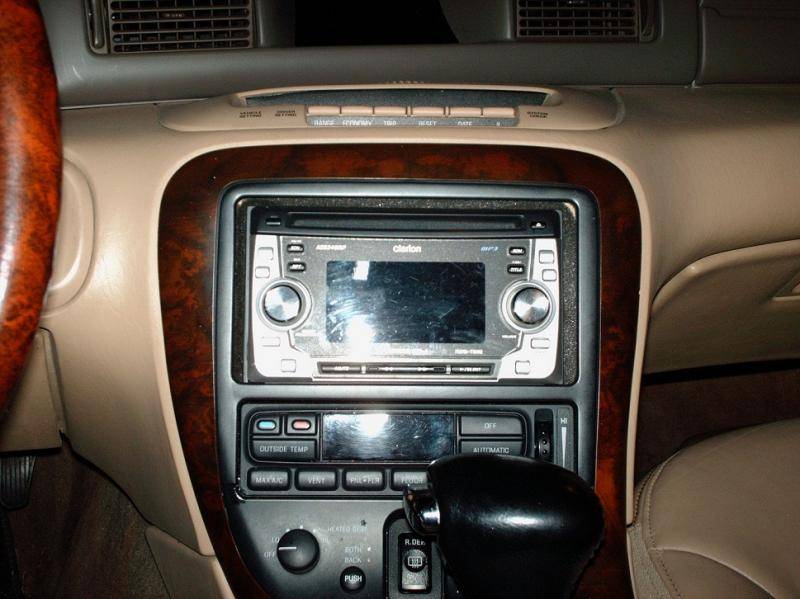

Looks like there is some module right behind/above the factory radio?
Can you relocate that piece to make space for a double din? I cant take not having a CD player anymore!
Whoever has done one please let me know.
You'll get mixed thoughts on this but you can remove the L bracket that the stereo rests on & flip it upside down & backwards. Then it will clear the overhead stuff & still support your new unit. I recall a bit of bending upward on the module but after you've made space on the bottom, you're looking at a little over a 16th of an inch. Of course you'll have to trim some of the plastic on the top & bottom, but not much.

I didnt have to move any bracket on eaither car. Just trim the ineer opening a little and thats it.
