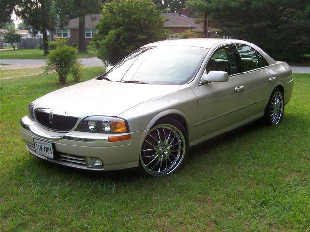

deez iz twenties
i drive a 2000 ls with 20s on 245/35r20 shoes. Ive not once had a problem with rubbing. I do tend to drive a little better, but the car still handels about the same exept for the bumpier ride. I love em...
