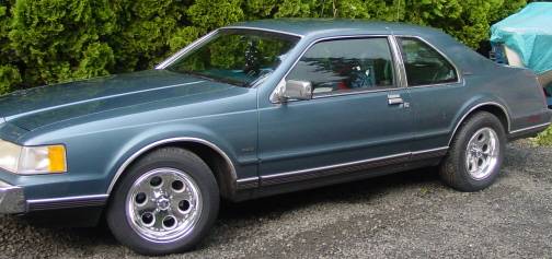

Just got done at the tire shop, 1 month in the working. I got ultra rims series 56 six shooters. I put 215 60r16 on the front and 235 60r16 on the back. Looks sharp except the back tires rub on rough roads. Gonna have to go with smaller tires on back.

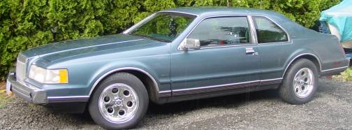

Here she is with 225/70R16's in the rear and stock P225/60R16 BSW Goodyear Eagle GT +'s in the front. Click to enlarge and I do mean enlarge!
The tires rub because those wheels have the wrong offset and stick out too much. I had 255/50/16s out back on my car and had no problems at all.
The 70's pictured above are the same one's that OldSchool2 had on when we were at Atco November of 2004. In the rear, I've never experienced rub. In the front, the 70's will rub on full left and right turns.
