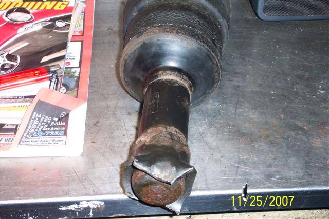

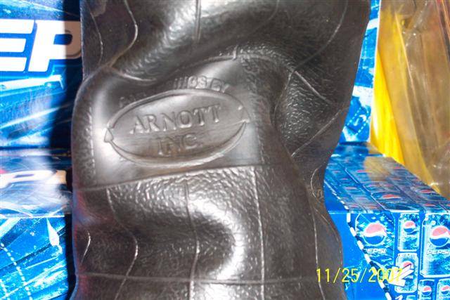

No, The problem was the bolt was rusted in the sleeve and i did not want to wreck my bushings and if i used air tools it would of ripped the bushing and spun in there attached to the bolt and sleeve and then i would of been up a creak with out a paddle

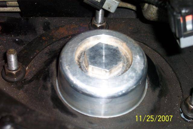

Eddie is the best i have talked to him and he is sending me a new one now just in case the one strut is no good because of the main billet cap was lose from the factory, some boby was sleeping that day at work ,that is a great company and i would recommend him to anyone and the good news is that i put grease on the oring on the billet main nut and resealed it and put it together and the car is standing up and for some reason it is running like a raped ape and the ride is smooth

Get a long Breaker Bar they have them at Advance for the giant price of $17.00 for a 24" one. still not enough, then put a pipe on the end, still not enogh, check to see you're turnin the right direction.
Yes i have the right tools i have been jamming on cars for a long time at one time i had 20 cars i was working on but those days are gone and life is easier with 1 or 2 or 5 or just enough for a week,my problem is rusty bolts and nuts and not screwing up rubber bushing with heat and a impact gun but i got lucky and i took my time and got them lose without melting my bushings
Don't for get about PB Blaster... great on the rusty stuff... much better than WD40...
Stuff smells bad but works great... Just adding more info for the lurkers...
Eddie is the best i have talked to him and he is sending me a new one now just in case .........that is a great company and i would recommend him to anyone
I never lie when I say Eddie's the best.... Easy to talk to and great help....
You call those other guys and they might talk to you if you get lucky... or you get some rep.. who is only out for the bucks...
Eddie is one of us... plus he worked for Ford a trained tech... knows his stuff..

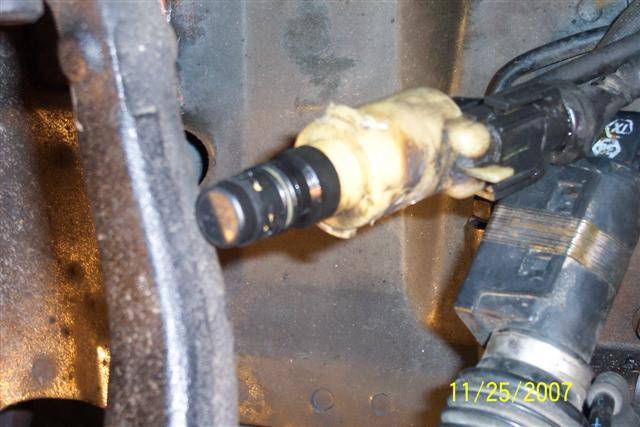

Pappa, normally another LVC member would have beat me to it, but the long holiday weekend prolly had most with family, glad I could help, still curious about the solenoid tip, what did Eddy say (I love that man, he will do all he can and more for ya), I've never EVER seen that top lug off!
