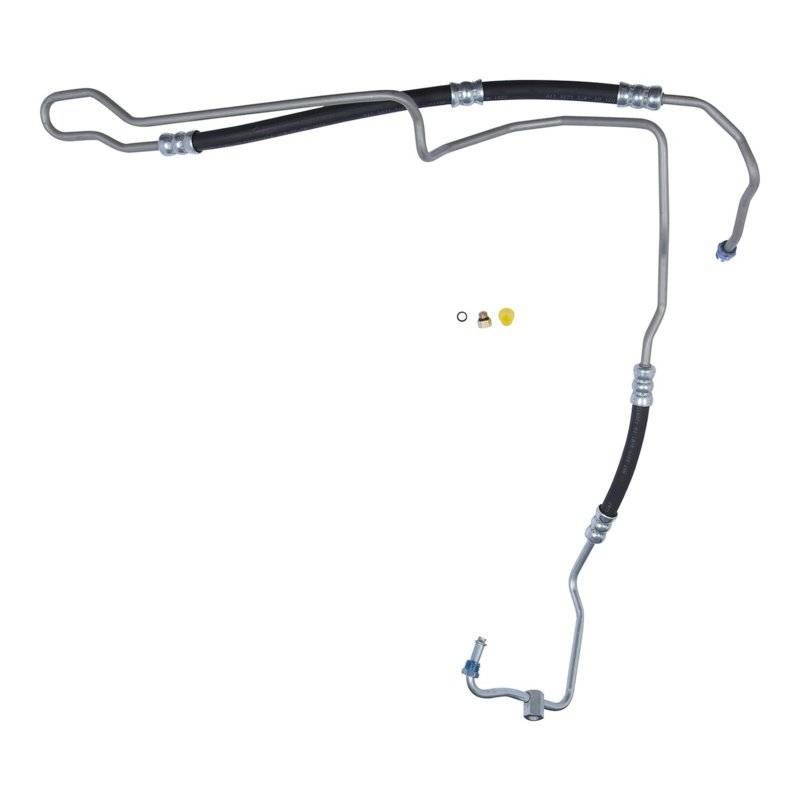

You could alternately get the high pressure hose that has the pressure sensor in the middle of it.
If so you are a lifesaver for helping me out on this. Cause I really did not want to send back this old pump as a core cause I am getting a refund on the pump since it was junk. I got this deal for $72 so I still feel like that is a steal being no core fee being involved! And with the refund on the old pump that should mostly cover the rest of the part cost.
I think so, but I'm not able to look it up right now.
I went with this one https://www.amazon.com/Edelmann-921...+Steering+Pressure+Hose&qid=1577066117&sr=8-1
Kinda figured that was better than the one locally plus they had to order it anyway so might as well save a few bucks. For the Pressure switch though is the standard motors one good enough or do I need to stay OEM?
