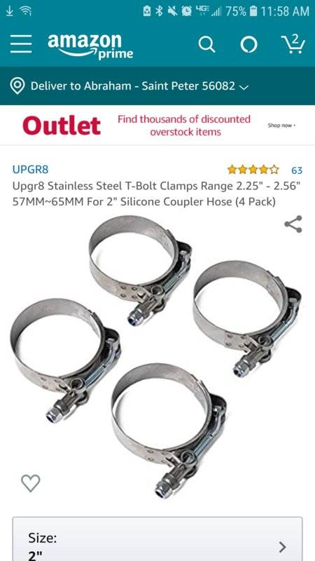

What about these?
Look at McMaster-Carr, there will be multiple options to solve your clamp dilemma.
It was solved as I stated in my last post. I have tested the clamps on the lines and they hold well. But I will check them out if I have any more clamp needs. But honestly after seeing the quality of BelMetric I really like them so I already trust them from what I can see and touch in my hand. I had the old aux pump and heater valve and tested how they hold and they were nice and tight.
