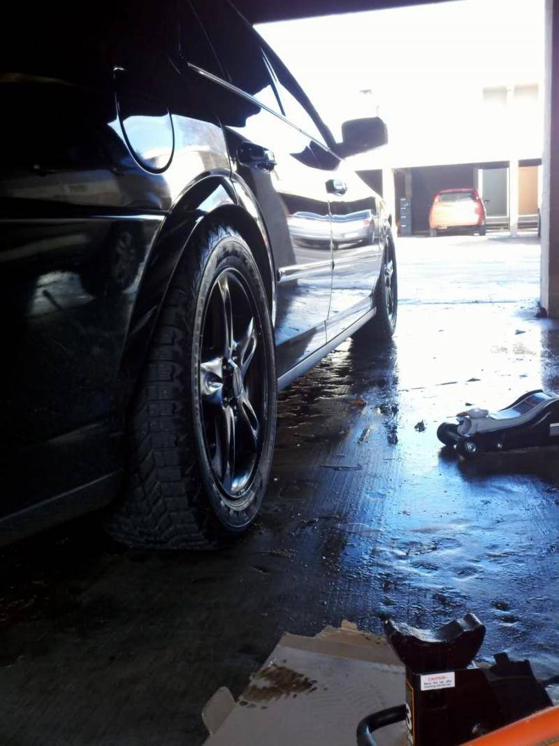

Trying to get them to sit like this: Guy has stock 17's
He had rubbing issues with that , also the spacers took much of the lug nut thread so the wheel isnt as secure
Didn't know that. So what would be the best route to take to achieve this look with the wheels I have?
Do what he did and get rubbing. That said, an 18mm spacer will give you an effective offset of 42mm. That's if my math is correct.......
your math is correct.
60 mm offset with 18 mm spacers is an effective offset of 42 mm.
