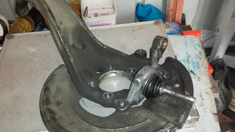

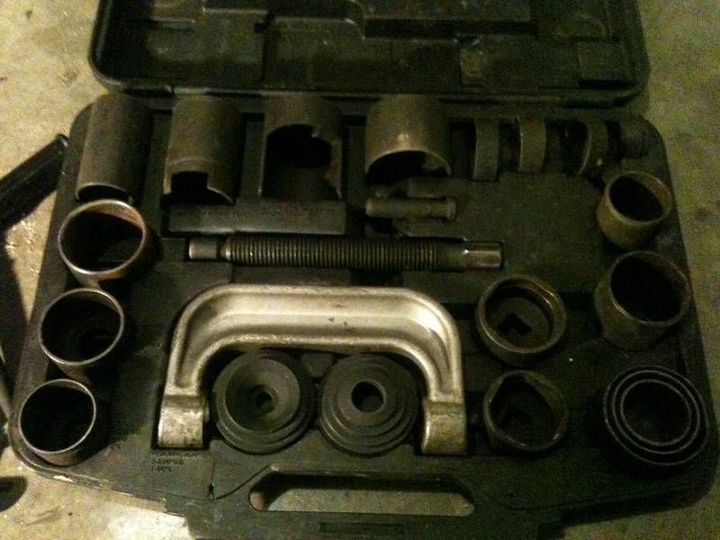

thanks for the replies. we were able to use the old spindles. I took each spindle to a shop that I knew had a press and knew how to use it. In the end they didn't use their press, they used their kit which is like what people here have already recommended
something like this:
they actually had a 12 piece set but needed to borrow a 24 piece set from AdvancedAuto because their set didn't have 1 specific sized adapter (tube/ring).
of course they had an impact gun to turn the tool (c clamp looking thing)

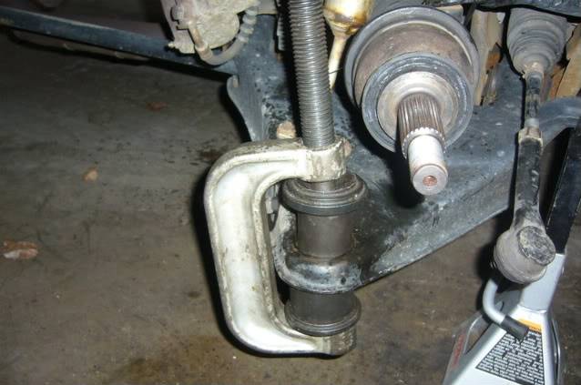

the setup looked like this but with the spindle in a large vice (this pic is not from an LS)
with 1 adapter (tube/ring) on each side
the one tube pressed the ball joint's lip, the other tube allowed clearance for the ball joint's stud to come out, and thru the hole in the end of the tool as it pressed in.
lip is at the bottom on this pic and the stud at the top.
this isn't mine but a pic I stole from good images (it is from a Jag forum actually)

do you mean the wheel bearings that are in this spindle too? no, we almost had to replace them though, but fortunately we were able to remove them and hopefully will reinstall them. (they aren't too old but were oxidized in pretty good)
the bushings in the lower control arm probably should be replaced now too, but I'm putting that off hoping I can do them myself (without taking it totally apart again)

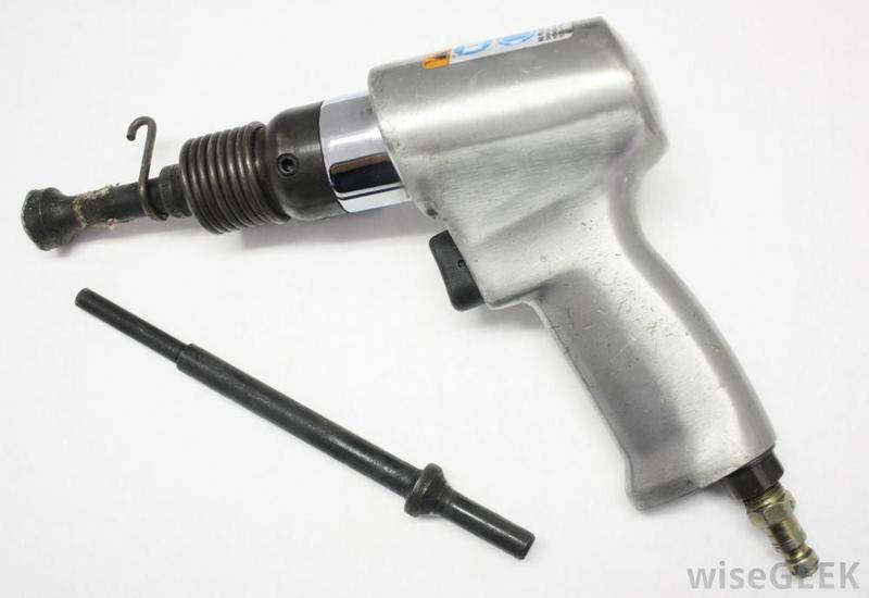

for removal of the old ball joints they cut off the stud almost all the way and used an air hammer to press it out. it took a few minutes of air hammering
seems like there could have been a more graceful way of doing this with the press tool kit.
