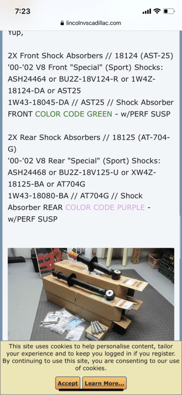

I had decided to track down what is believed to be the correct, firmer shocks for the 2000-2002 LS, with the V8, with the Sport package. From information seen online, I believed that the correct part number for the front is: BU2Z-18V124-R, ASH24464 or 1W4Z-18124-DA. I was/am under the assumption that these part numbers all correspond to the same part.

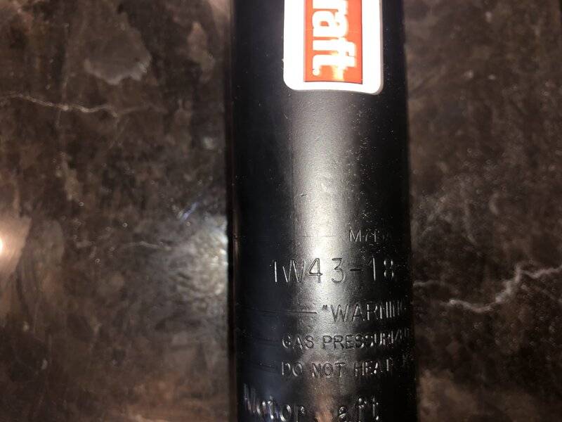

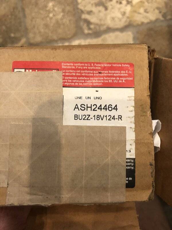

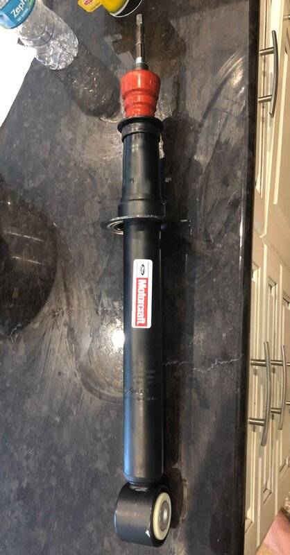

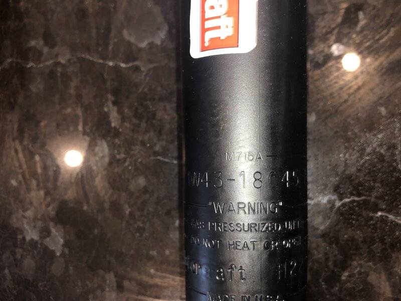

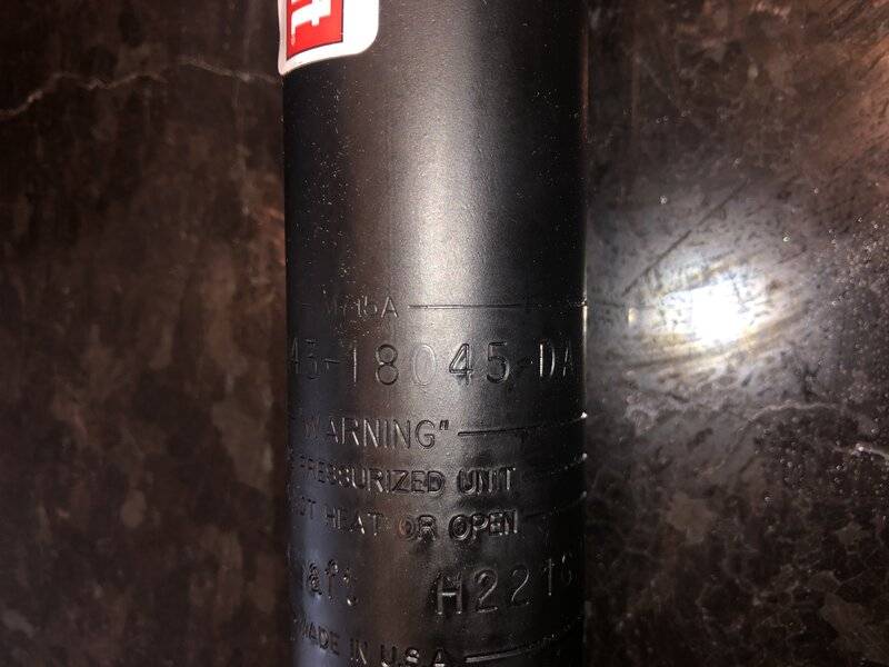

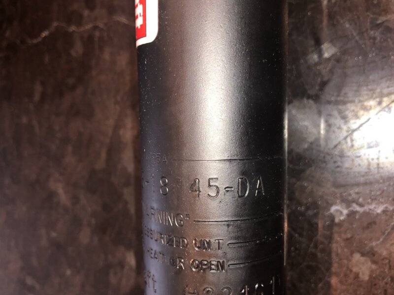

I found one available via FordPartsGiant. I requested part: BU2Z-18V124-R and was told one was available for purchase. I bought the shock. It arrived today and the part numbers on the box are: BU2Z-18V124-R as well as: ASH24464. The concern is that the part number listed on the shock itself is: 1W43-18045-DA.

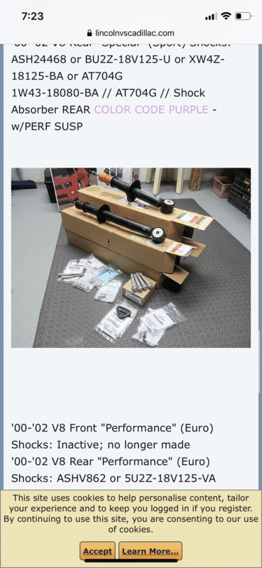

From what I have read online, part: 1W43-18045-DA is the part used for European models where roads are often times more rough, and therefore the shock provides a bouncier, cushy ride.
The greater disappointment to me is that I went through the effort in finding the correct Ford shocks for my V8 Sport about 6 years ago and what was installed on my car (and is currently on my car) are shocks: 1W43-18045-DA.
So, does Ford have the wrong part in the wrong box? Do we have the wrong part numbers for what belongs on 2000-2002 V8 Sport? I do not know. Bottom line is that ever since I switched out the shocks on my LS years back, the ride has been soft, very soft with these 1W43-18045-DA shocks.

I also had installed new rear shocks. The part number on my rear shocks are: 1W43-18080-BA. Online, this corresponds to the "performance/European" shock. The correct part number for the rear V8 Sport shock should be any of the following: BU2Z-18V125-U, ASH24468 or XW4Z-18125-BA. I'm afraid that if I try to source the correct part, again I will receive the incorrect part in which I already have on my car.
Front and rear shocks I had replaced on my car are bouncy. Not firm whatsoever like the originals were.
The European shocks for the Gen 1 Sport are supposed to be firmer... from what I understand. Not softer for bumpy village roads... but for the highways in Europe.
Best way to see what shocks belong on your LS... is to call your local dealer and give them the last 8 digits of your VIN#
If it doesn't take the Euro shocks... then somebody else installed them at an earlier point.
If your Gen 1 LS is not actually a sport... and you want the Euro shocks... then look for a member on here that has a Gen 1 Sport... and see if they will let you use the last 8 digits of their VIN #.
