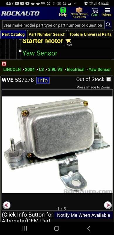

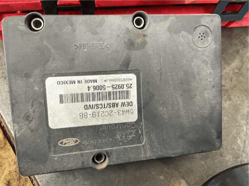

Get you abs/advance trak refurbished at AutoECMs - Buy Refurbished Auto ECMs - BCM, MAF, ABS, TCM, GEM & More and the info on your abs unit and yaw sensor. Had my 04 LS fixed recently.
