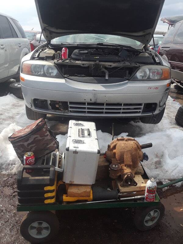

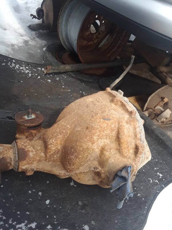

Okay, got me the differential, going to put it in today, yeehaw. Cost me about $75 at the Black Friday junkyard sale(see my posting re 50% Junkyard sale, wow). Of course there is the risk of a bad diff but visual inspection and turning the pinion and cvs convinced me that this diff is at least better than the one I am pulling out.
I was correct. You CAN remove the CV without needing to remove the axle nut. The wheel assembly which is what the CVs ride inside, comes off the car with just 3 bolts. There is one big nut at the top ball joint, a small nut and bolt at the (control arm?) ball joint and one big nut and bolt at the bottom that holds it all in place. You'll have to remove the caliper and the mount to get at those but the three bolts are easy to remove and then everything just slides right out, maybe with a nudge between the CV and differential to disconnect the inner C clip.
Once the CVs are out you just remove the 6 bolts holding the Diff and drive shaft(Torque tube) together, then the bottom diff mount bolt and the two rear diff mount bolts. Use a tranny jack or some support because once the 3 diff mount bolts are pulled everything drops suddenly.
This is way easier than I thought and not as hard as the old style live axles. Anyone who can do disc brakes can drop the diff, with proper equipment(tranny jack). The hardest parts are not enough room to get much swing on a wrench and that diff is heavy if you are working on your back.
Well if it doesn't rain I am going to head out to the driveway and swap diffs.
BTW, I complain how the Lincoln LS designers made this car hard to work on in many cases, but this job is a snap and requires just a handful of wrenches.

I was way off(too high) on my net cost for the diff. I just returned the core and looked at the receipt. My Net cost for teh diff which is happily spinning away in my LS, was ONLY $37.49.
I would guess My estimates were based upon what some yards call Rotor to Rotor assembly, ie the differnetial, CV joints, wheel assembly and disc assembly etc. Which averaged about $154 to $200+
The carrier can be priced out separately So my list price was about $75 and my net 50% was as above. Can't bea that deal with a stick all year long. Jeez. From fearing I would pay over $400 down to essentially scrap metal cost. And like I said it appears to be working well with no leaks, no metal in the original oil and no play on any of the shafts.
I still need to replace the carrier bearing for the torque tube, soon as the part arrives.
