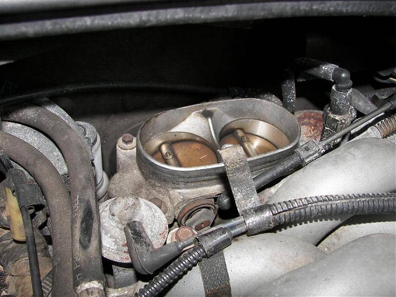

Hey guys. Before I go any further if the IAC or EGR were faulty, would either one of them always through a CEL on a gen 1? The recurring problem I am having is when I crank the car up, it will sputter for a second and finally die unless I keep giving it gas then it will stay cranked. Hot or cold. I've changed just about everthing over time. Plugs, wires, both coils, both o2's, crank sensor, cam sensor, cleaned MAF, several seafoam treatments. The car runs fantastic other than it shutting and cutting off every blue moon. I've check fuel pressure it stays steady at 35 at idle even when it tries to cut off. Now, the only thing I haven't replaced is the IAC or EGR because they are such a PITA on my 93. Could it be either one of them? I'm gonna change em both anyway. Oh yeah, no CEL at all. And of course I've searched first.
