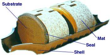

Guess I was wrong. Rattle still there. Either one of the cats has a broken honeycomb i.e. substrate separated from the metal and is loose but can't get past the pipe outlet diameter but occasionally jamming in place, or something metal on the exhaust above the trans is possibly causing it. Rawer gas out the pipe is evident again, like when it had troubled COP.
Anyone know if either cat is solid throughout, or is there a gap between substrates on these? IIRC, some cats have TWO actual substrates like:
Guessing it's the cat higher up as the one that Y's to the single out was solid when I tapped it.
