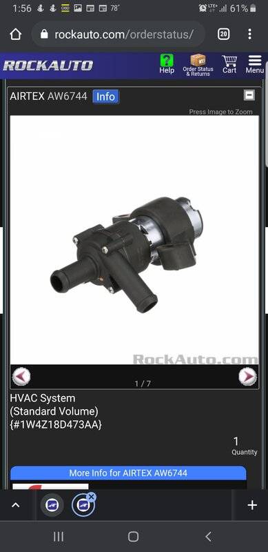

Yes that's what I was thinking, ha, maybe I'll try running new power wire and give it it's own fuse or something then. I didn't find any motorcraft options for that part unfortunately. Here's what I got, it was the last one, they don't have any of any type listed any more. Maybe I'll try a pick and pull part place.
Yeah, stay away from Airtex for sure. Bosch should be the actual OEM for the pump. You can also search for the Jaguar S-type aux pump.
