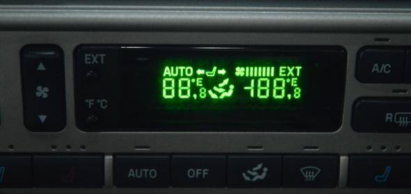

    Hi guys, I ran a DATC code test today and this is what I got. I don't know what it means but I was told that if everything is good, it should read all '8'! Well, from the snapshot, there's one digit that I don't recognize. Does anyone here have seen this code before or if you know where to point me to, I can look it up? Thanks in advance guys!
    BTW, the reason I'm running the DATC test is because I'm having A/C issues. Blowing warm air only! Not sure if there's a leak in the system or compressor malfunction. I know it's not DCCV because I replaced a new one already. Any help or input would be greatly appreciated.

    That is the everything passed display. Whatever the problem is, it isn't being electrically detected.
    Time to look at the high-side and low-side refrigerant pressures.

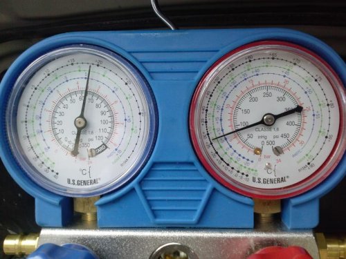

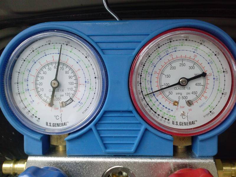

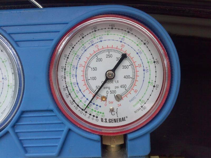

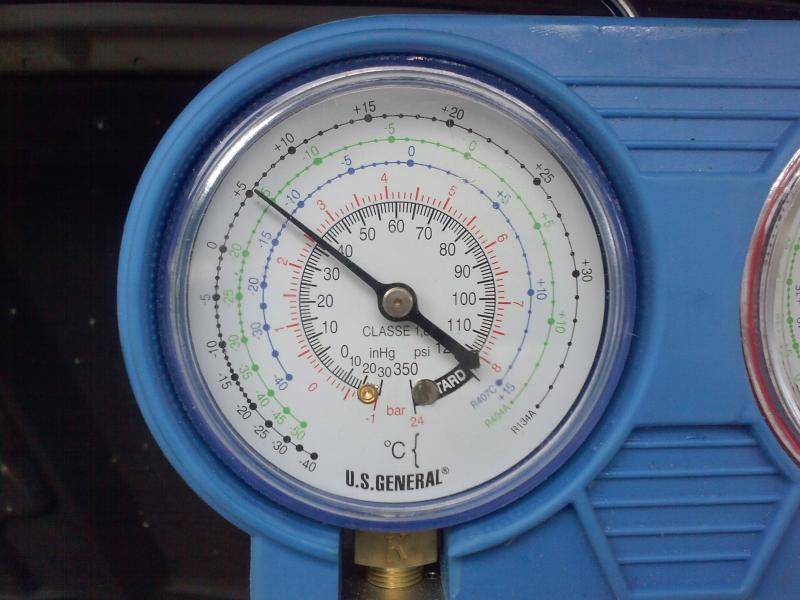

    Ok, I got the results and readout from pressure measurements. BLUE gauge is LOW side and RED gauge is HIGH side and from the looks of it comparing to the link that joegr kindly provided, the low side seems to be ok but high side is WAY LOW. According to the diagnostic table chart, my results tells me that it could be A/C suction line is partially restricted or plugged? Which really doesn't tell me much but it also could mean a number of other things not related to the chart. Joegr, you could be right also about me not knowing that the oil from compressor has been leaking slowly and I decide to pump a whole can of R134a into my system. If that's the case, I'm not really sure what I want to do next.

    Most likely, this is indicating that your compressor is toast. On the other hand, it is possible that your expansion valve has failed in the full open position (but that's a rare failure, I think). I don't think that it could be a suction side clog, since the low port is right at the compressor, and you are not seeing extremely low, low side pressures.

    Joeger advice spot on as usual! I am an A/C certified mech. At the very least the clutch is probably bad, dried and accumulater bad. The high pressure line looks fairly good, suction side real bad! System needs full vacumn cleaning, purged with nitrogen after all parts replaced, before new compressor is opened and introduced to system. Compressor failure/blowout has introduced contaminents into system. A trained tech can rebuild the compressor easily, 2 parts come apart and replace clutch assembly. Most repairs are a replacement of the compressor/clutch assembly. Big business in rebuilding these. Go back to 1950s & 1960s A/C. Front windows down, 60mph. Good luck!
