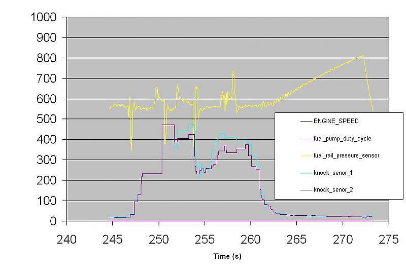

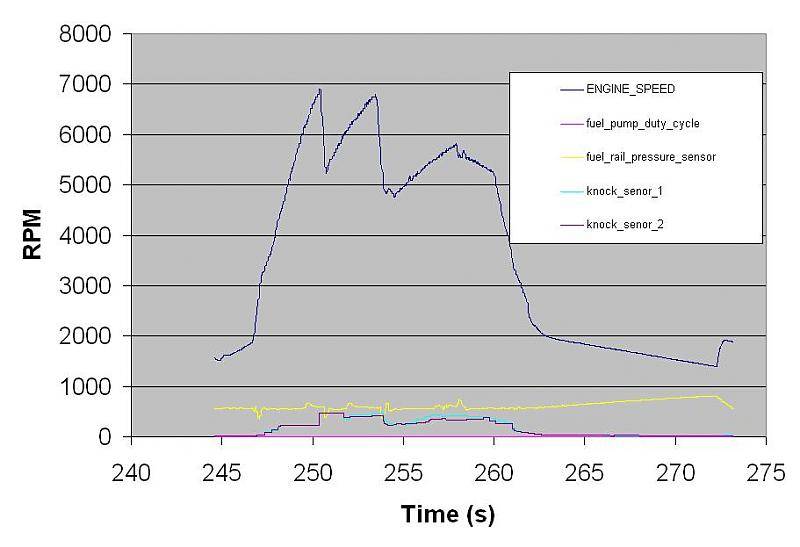

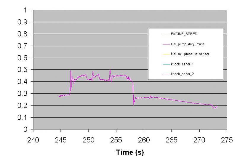

These are all the same log while i was tuning my nitrous. The bottle was starting to get low. Was keeping an eye out for fuel starvation and timing pull. Fuel pump gets maxxed for a split second (multiply by 2) so cant run more power. Timing was comparable to a stock run so while the chart doesnt make sense, I assume theres not too much timing advance. You can see i stepped on it for 3 gears then slowed down while still in 3rd.
