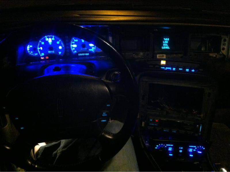

Has anyone changes there dash lights to LEDs I just did and everything looks great but they aren't wiling in the climate control was wondering if anyone knew anything about this
what leds did you use sir. and were they direct plugins or a rewire. because i would so be down to do that. not sure what the deal is with the havic controls but i could care less if those were lit or not.
Maybe the CC isn''t working because you need to add oil. :slap:
I wonder if this mod is pretty simple and would work on a gen1. Im hoping you found some plug and play LEDS and didnt have to do a full rewire. in the picture the gage lights look super bright. not sure i like that. i imagine its even brighter then the picture presents.
It might just be direct plug and play. I know it would only be possible to go from green to blue. I checked this before. The parts have a blue filter on them so when a yellow halogen light hits the blue filter it turns into green light. Now you could do some real modding and changed the blue filter to clear and have white lights... some where down the road. But he may have done some soldering for the steering wheel lights because I don't remember them having bulbs. Also, the window and unlock buttons would need new leds.
I just bought the right size bulbs from superbrightleds.com the gauges are bright but not as bright as the pic

I must say im very pleased with the results. its not spotchy as a lot of people said happened to them. heres a couple pics from my gen 1.
i tried to get the entire back side to show there is actually 9 bulbs required for the cluster of a gen1. not sure how many in the gen 2 like the OP has
The cell phone really does no justice for the way its light up even when you use video. speaking of which here is a video as well. I really love the way the turn signals look all blue as well dont remember if i recorded that or not.

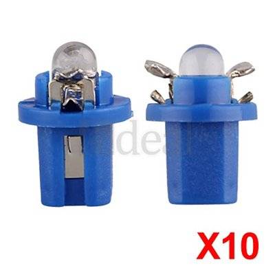

http://www.ebay.com/itm/400326651491?ssPageName=STRK:MEWNX:IT&_trksid=p3984.m1497.l2649
these are the blues that i used.
http://www.ebay.com/itm/190712898734?ssPageName=STRK:MEWNX:IT&_trksid=p3984.m1497.l2649
these are the whites i used from my other video. however i would suggest finding a different sell as this one only sent me 1 out 10. they are offering to either give me full refund or send the 9 out. however its still a PIA to have to deal with.
