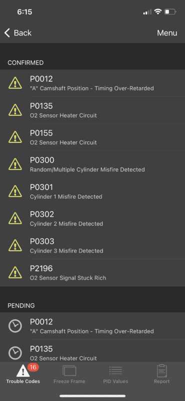

Recently picked up a 2006 LS V8 with an engine issue. I’ve attached the codes but here they are
P0012
P0300
P0301
P0302
P0303
The o2 codes are up because the guy cut the cats out of them. The other codes were there before that.
Cylinders 1, 2 and 3 are the Passenger side bank correct?
I checked the coils, they were all .6-.7 ohms, the plugs are newish iridium and the gaps are at .039. I pulled the VVT solenoid and put 12v to it, it open/closed about 1/4” seems okay.
Any suggestions are welcome! Thank you!

Camshafts are out of time, the flats do not line up.
Sorry to hear that. The 2nd gen 3.9 does not usually have this problem.
I believe the intake camshaft bolt came loose or the intake gear failed internally as I was able to turn the intake camshaft freely from the gear 1/8-1/4 turn and then it locked up.
