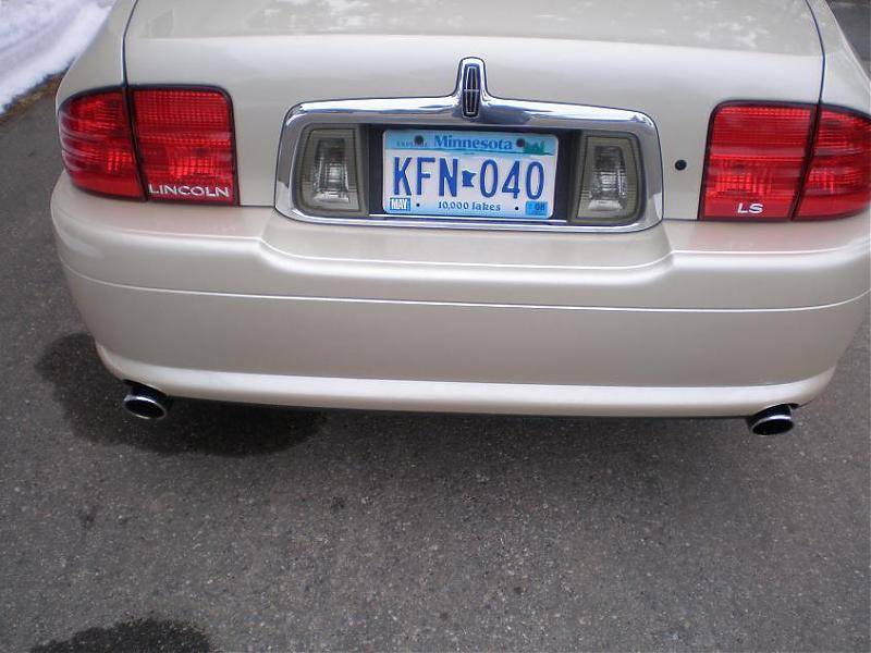

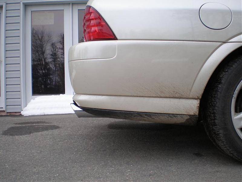

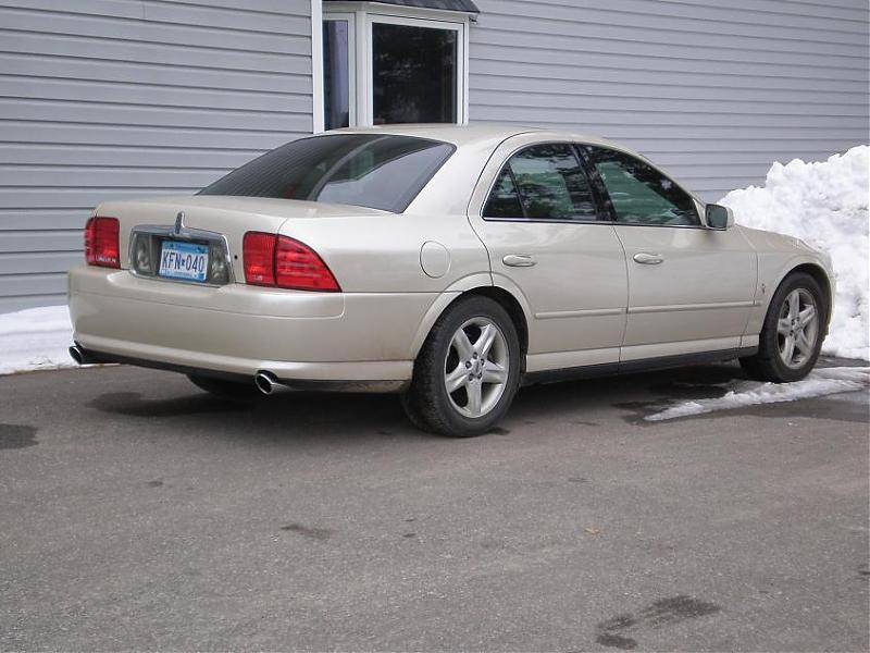

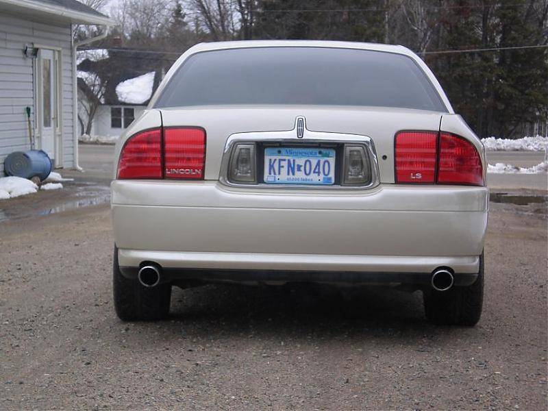

Just got back, and not too happy. Happy with the sound, but the tips don't line up properly. They're good depth-wise, but the driver's side sits too low:
Actually, to me they both sit too low. Should I get them both moved up higher? Or just the driver's side?
From the last picture from the rear the drivers side does look like it needs to be moved up a smidge but it is hard to tell without seeing them in person.
Did you do all the cutting and they put them on?
They look good, I was nervous to want to cut into the bumper but you got more balls than me.
You can try to push up on them and see if they'll stay..? Doesn't look too bad at all. I've seen worse lol
that looks good, the removed bumper looks oem IMO but they can do with sitting a little higher which shouldn't be such a big problem. take it back to them and i'm sure they'll do it just to make you happy, unless they are a bunch a pricks
So, the story on how they got low like they are.
When we brought it down off the lift, the driver's side was perfect. The passenger side is where it is now, which I thought was a little low. I tell the guy that I want the passenger side higher to match the driver side. He says that they are easier to bring down then up, so he sticks a piece of pipe in the driver's tip and pushes down. I hear a big "creak". He bent the metal piece that holds the rubber hanger to the frame. He says he can do the same to the other side to make them even. Of course, I wasn't happy, but figured I'd at least give it a try, and see what you guys had to say before I had him fix it. Looks like I'll be giving him a call.
And yes, jk52781, I did all the cutting. Used both a dremel and a jigsaw. I feel my cuts came out pretty good.
You can do the same thing with a piece of pipe..just stick it in and push the tails up. I know I've done that with NickT88LSC quite a few times.
Or just bring it back and have them do it. :D
