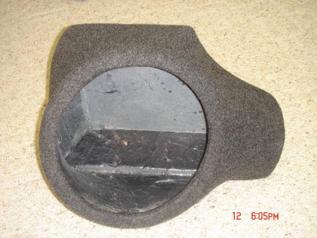

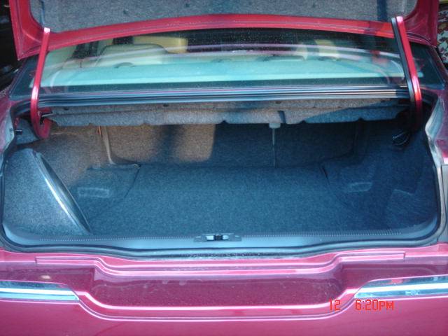

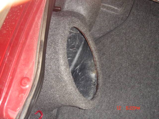

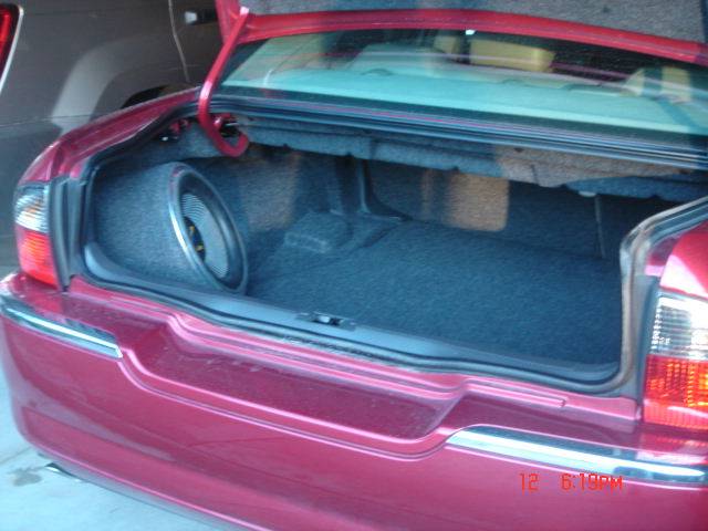

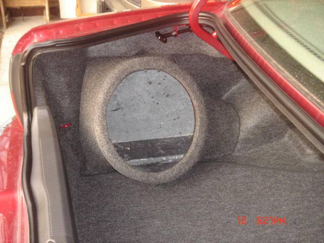

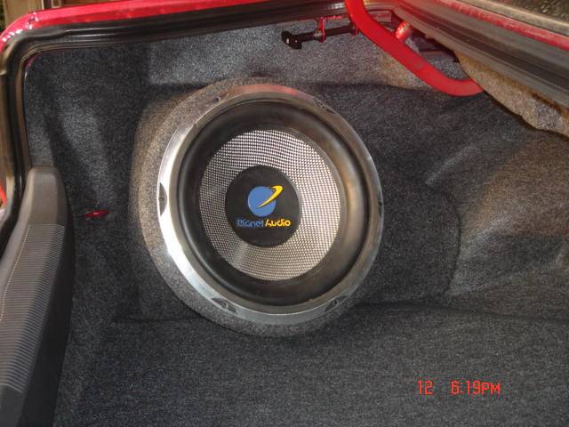

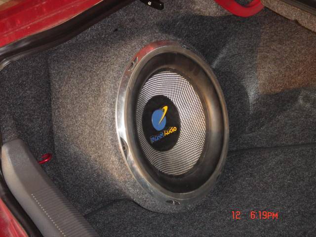

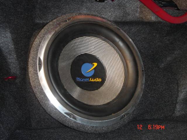

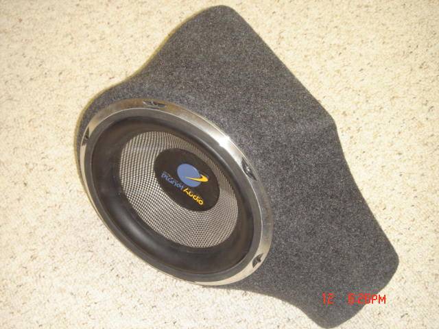

I've been a long time reader of the great posts here, but never have i posted myself. I guess untill now i really never had anything worth getting imput on untill now. My company has just made a prototype subwoofer box specificlly for the Lincoln LS. This box is designed to fit in the wheel well of the trunk. We basiclly took the useless space in the side well of your trunk and utilized it to it's fullest. It's made outta 3/4 inch MDF and a high density fiberglass cloth, made with a seamless design this box will handle anything you can throw at it. This one was designed for a 12 inch sub, but if feedback is positive we will also design a 8 inch and a 15 inch. The one problem I know anyone that has a stereo in there LS has come across is what happens when you have a flat or need to get to the battery, you have to unhook your speakers and remove them. Well problem solved, you can access your spare and battery without even moving the box. It's carpeted in OEM color match carpet so it blend right in with the rest of the carpet. I've included some pictures and I'd greatly appreciate you imput on this product, let me know if you like it, if you would buy one, how you would want it, what i can change about it to make it better, or anything that you think is important. If you want to email me something specific you can email me at crustbomb@aol.com thanx for checking this out, and i look forward to getting your feedback

interesting.. kinda steep price for a box.. but im assuming it would be both sides for that price range.. or so i hope.. i woulda bought it if i didnt already have a custom trunk.. that and i doubt the L7's would fit in there.. looks kinda weird facing in.. but it send more air to the inside of the car.. it looks a little out of place though.. the new dodge neon SRT comes with an enclosure like this one but its hidden.. i would take a look at something like that...
i know which ones your talking about.... most of the ones that mount flush like that are made for either a 8 or a 10 inch sub... this is for a 12.... they are also primarily made outta wood... which takes away alot of the look..... the problem that we ran into with the design of this car's box is that the trunk arm still needs to shut..... and in order to have a decent mounting depth for the sub and also enough air space, it does have to stick out.... take a look at some of the flat front boxes, and then look at this..... even tho it sticks out a tad, I can say that it defiently looks better....... as for the kickers... were looking into those too..... so many options.... we just don't know which will fly and which will flop..... it's way to expensive to develop all these differnt boxes if were only gonna sell a few here or there... thats where you guys come in.... tell me what you would buy....

you'd acully be surprized, it's a good size.... airspace is about 1 cubic foot which is about average for what a decent 12 will need
as far as the L7... they only need .88 cubic feet in a sealed box.... the need about 1.75 in a vented box... which will be bigger than the one posted now.... sealed i can do no problem and keep it about the same size... let me know exactly how you'd want them.....where the speakers point..... angle, towards front of car towards rear of car..... carpet, leather, painted..... i'll try to put something together
ABSOLUTLEY... all i would need to recess the sub would be the exact demensions of the sub...we've done the recessed sub and it looks great.... let me know if your serious about this and we'll work something out

hey bangin..... you do know these boxes are fiberglassed right..... the only part of this box thats made outta MDF is the bottom and the back piece..... i could send you these things primmed and ready to paint so what ever you do with the rest of your trunk you can just paint match these to that.... as for the ports for the L7... i got a few people working on trying to get a 1.75 cubic foot box to work in that area and still allow functionalitly if the trunk..... and i must say it does look like it's gonna be possible, so just keep checking back and as soon as i have some info on it i'll post it.....
