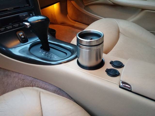

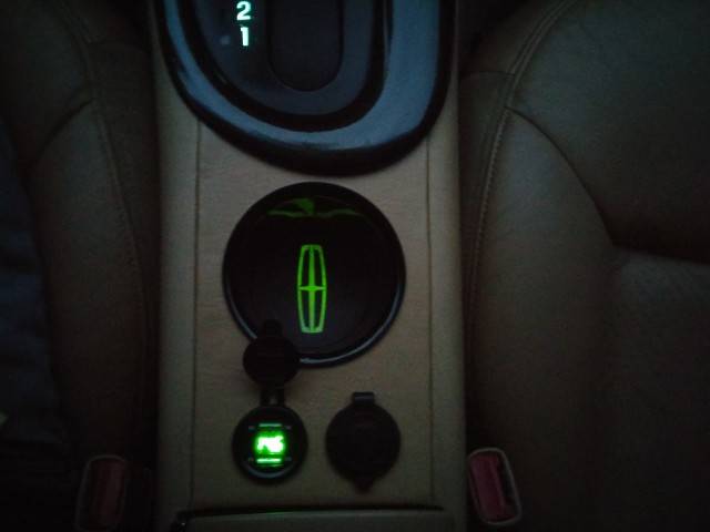

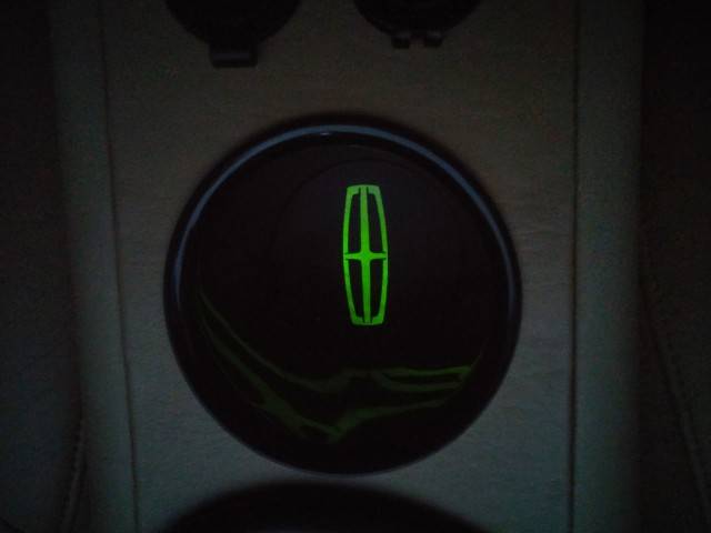

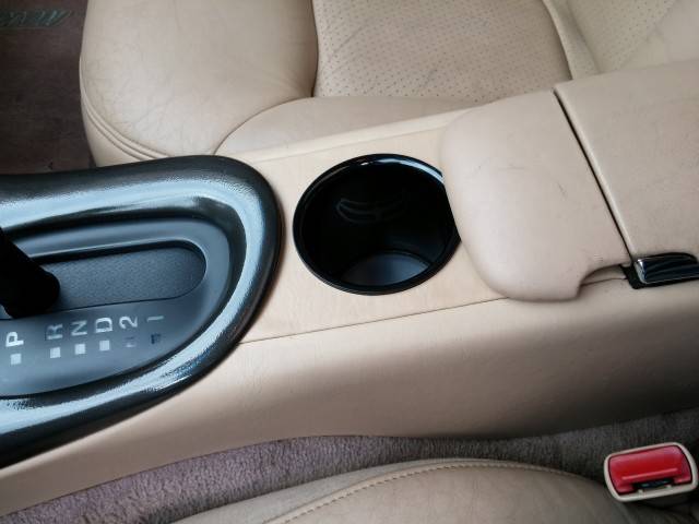

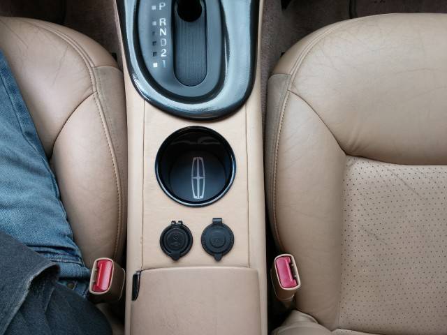

The base is a modified gen2 assembly. I used a pair of door handle bezel leds as the cupholder back light. Subwoofer port cut to size (4"~ deep/3.25~W and will actually hold a drink), oem console vinyl (?), generic usb/voltmeter and 20a outlet. Cupholder uses the existing ashtray light wires off harness (Turns on at dusk), 20a socket is elongated/fused and ran off the oem cig lighter wires and the usb/volt was ran to the fuse block to run with ignition. I plan on shortening/modifying an oem cup holder cover to hide the outlets. I'm saving that for another day..

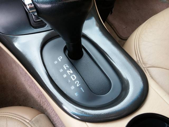

I also plasti dipped a worn out shifter panel-

Great quality work! Looks awesome and including the emblem in the design is Sweet! Looks like stock - Fantastic!
