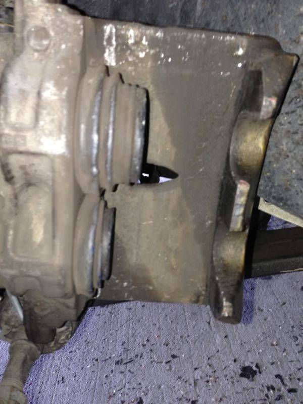

I'm having a creaking noise coming from my front drivers side everytime i apply the brakes to come to a stop as well as an almost like a popping sound that seems to come from the engine bay, reservoir area? Not from higher speeds (at least its not audible in the cabin) but from 15-0mph.
Took the brakes apart today. Compresed the pistons, closed up the reservoir, and pressed on the pedal with the caliper off to see what happened and found this:
I'm very inclined to believe this is not normal but im no pro, and dont know if maybe the caliper acts weird if the brakes are applied with no resistance from the brake pads and rotors. Is this a bad caliper? Could it be causing my issue?
Also eventho my brake fluid level seems to be ok, it seems like a small amount gets past the cap and leaking out. i've cleaned up the reservoir and closed the cap tightly several times. Is this related? Is the cap not making a good enough seal? The car seems to be stopping fine otherwise.
Hopefully someone will answer quickly before i have to take the other side apart. Thanks in advance.
I would hold a little pressure against the piston that extended to see if the other one would start coming out then. If one has a little more friction than the other, then only the one with the lowest friction will start to extend if there is no pressure against them. If you put pressure against it and the other one still won't come out, then you have a problem.
I would just put the caliper back on and pump your brakes a few times, then take it off to see if both pistons extended out. Might need to start the engine to draw vacuum if it's too tight to remove.
Did as Joe said and the other piston did extend out. Put everything back together and the noise is gone :confused: but im sure itll be back. Its happened before. I take everything apart. Fiddle with it. Put it back together and the noise goes away for a day or 2. Then comes back. Ugh.
