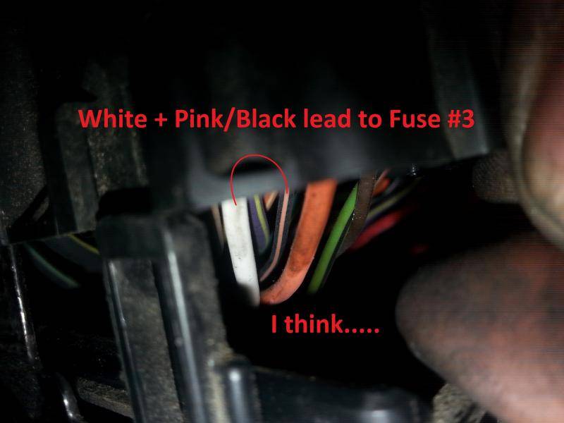

I got the voltmeter, put it to the fuses in the engine bay and got some strange readings(may be normal but since I'm not an electrician is strange to me).

Im not sure what this is indicative of, if any, as the fuse never blows and would like to know so that my DD can come back to life. I opened the relay box a bit to get a glimpse of the wires and believe I see a Solid White and a Black with Pink stripe leading into Fuse #3. However, I only see a White with Black striped wire within the bundle of wires leading to the PCM. I just need a diagram to get an idea of what I'm looking at. Online searches bring up diagrams for 97 Thunderbirds/98 Mustangs and am not certain if the pinset is the same as ours.
I'll feel so dumb if it turns out to be something very small and simple, which knowiing my luck it will be simple in the end.
