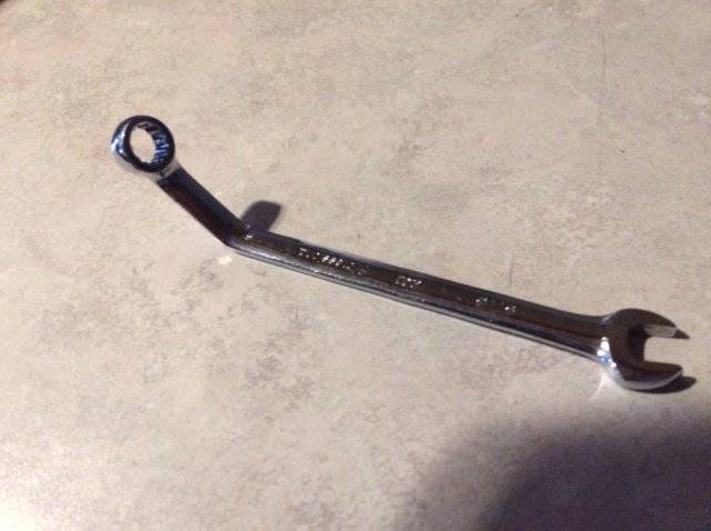

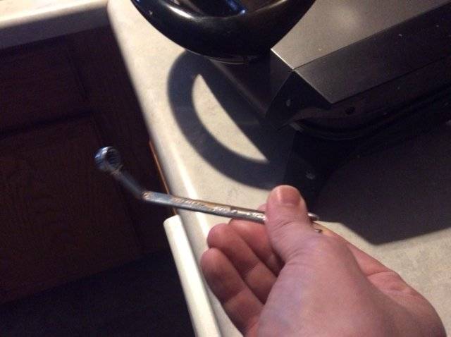

I suggest bending a 8mm wrench or buying a brake bleeder wrench and yes use a long needle nose pliers to get those last few turns on the 8mm bolts on the T-Stat housing
