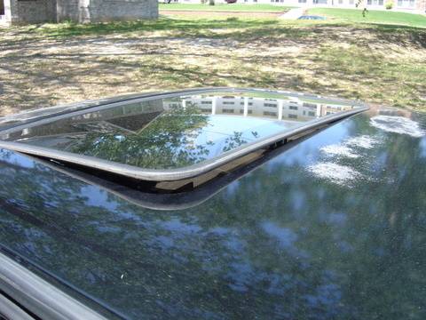

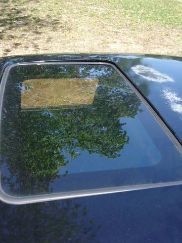

Well this just happened randomly the other day...
Looks like the drivers side may have jumped off the track but I can't tell
When go to open it it looks like the passenger side would clear but its getting hung up on the driver side...
Then when you go to close/vent the passenger side will seal but the drivers goes to vent??? :confused:
Here are some pics... It may make more sense this way

There seems to be some problem with the cable on the passenger side, Did you crank it all the way back? with out the motor. You never know what could be causeing that side from binding up. Both cables run on either side of that screw gear. the passengers is not sinked with the drivers it is behind of were it should be, Like I had said I think your only option with out pulling the frame is to Open roof to vent (like top picture) have motor off, push or yank the passengers side up to match, hopefully the cable on that side will pull past the gear, and get closer to were it should be.
Like I had said both cables on both sides run from the glass back and meet on that screw gear above the motor. something got in there and casued that side to get out of sink, If you can get the roof in full vent, You can get some lubracant on the cables that will help.
