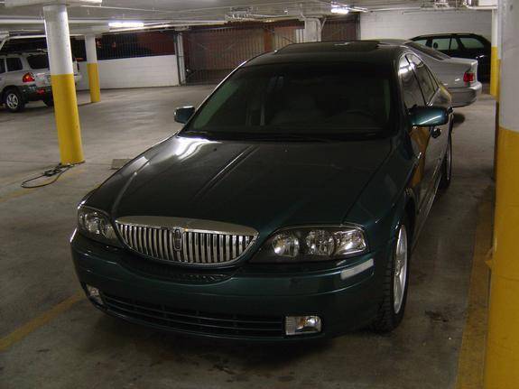

I amused myself this weekend, since I am going to upgrade (probably) to a Mclaren grill I got some chrome strips and put on the grill.. Simply Peel-n-Press.. From ebay... Looks pretty good... Gonna take some pics tommorow for ya.. The only problem is that you have to custom cut each piece sine the grills slightly turn inward and leave the bottom edge angled... Took about 3-4 strips (of the 22 you get) to get the pattern down.. Impressed.. I'll post pics tommorow

I like the layer of dirt.. Gives it that Texas Flair! :slam
They're pretty durable.. they're about 1/8" thick. I sprayed mine w/ a thin layer of clear coat before putting them on to make them alittle bit more durable w/ some extra protection (not much though ;))
They come in different rectangular strips of different lengths.. One for each strip on your grill + 1/8" for trimming. I took off my grill, cleaned and used some degreaser I had laying around. Put the grill on the ground, lined up my strips so that I know which strip goes to each strip on the grill.. The last thing I wanted was to end up w/ a short strip of chrome for a long strip on the grill.
I put the top of each strip along the top lip of the grill.. Then I made a mark on each side at the bottom of the strip where it meets the grill.. (One side of each strip was higher or at an angle the farther away from the center). Cutting the strips w/ wire snips... The rest was peel and seal.
Took me about 30 minutes to put on the strips once I got the rythmn down.
ummm.. You could leave it on.. I just found it easier... But I could have done it without takin it off.. It's just four simple screws and four compression clips... Easy to take off.. But would be just a easy having it on...

I applied the clear coat to the chrome part, and on each end... On the chrome so that it gives it that "little" bit of protection.. and on each end so that water can't seep in between the chrome and the inside
