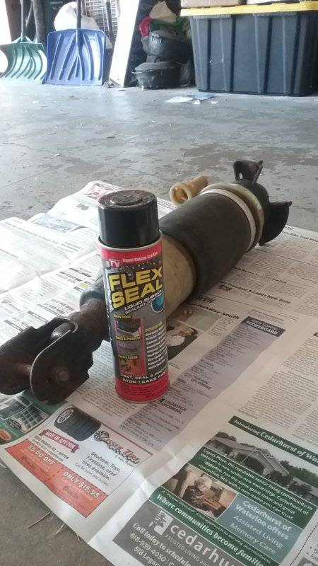

Has anyone ever tried to Flexseal a strut? Mine has devoloped a slow leak due to its age and the good old Missouri road salt.
Soon after making that post yesterday, i ran up to the local Walmart and picked up a can of flexseal. Going to put a few layers on the strut that i could remove and I'll post the results
