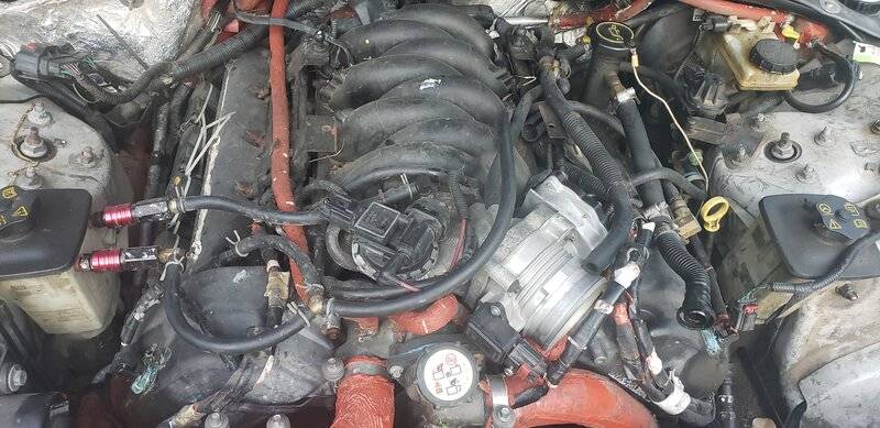

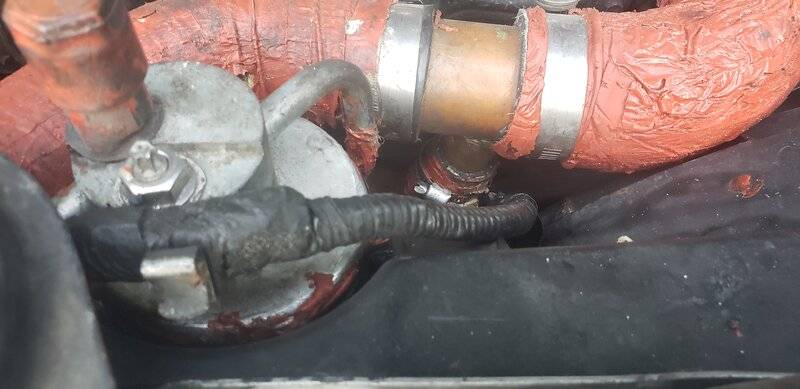

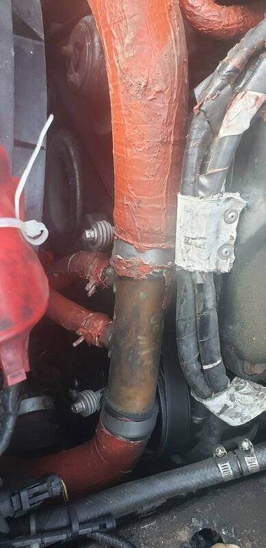

These smaller hoses I found have leaked only when driving. The hose from under the intake should be replaced with the other two at the same time. Use oem. I had mystery leaks from these. I had substituted the plastic pipe with copper as these were made new two to three times. I have placed the bleed line into the degas bottle. Simplifies bleeding. The clamps from McMaster-Carr on the hoses use belleville washer to provide constant compression like the springs clamps.
