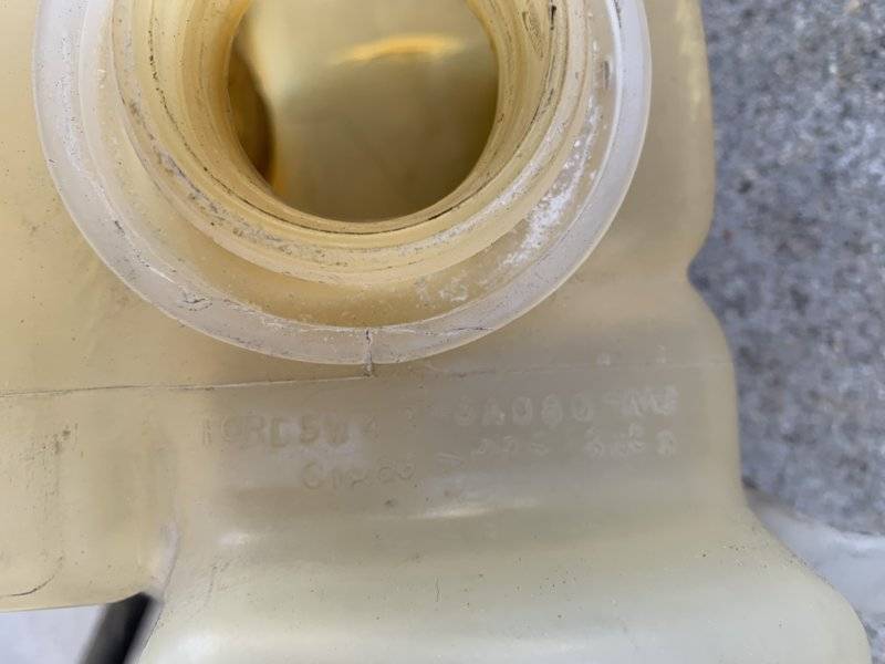

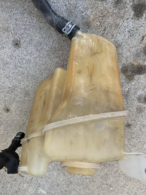

Well here is what the degas bottle looks like that I took out of the car. This was supposedly changed 3 years ago. I even have the receipt.
Well the cap was definitely leaking a little. Not sure what I'm looking at on the degas... but keep in mind that most dealers don't keep a ready supply of LS parts in stock. They MAY have installed an aftermarket degas.
Look for any Jag/Ford/Motorcraft markings or part #s. If none... It might be an aftermarket bottle, and they are known for only lasting up to about 3 years.
If you can prove it's aftermarket... And you got billed for Motorcraft pricing... I would make issue with that to the dealer.

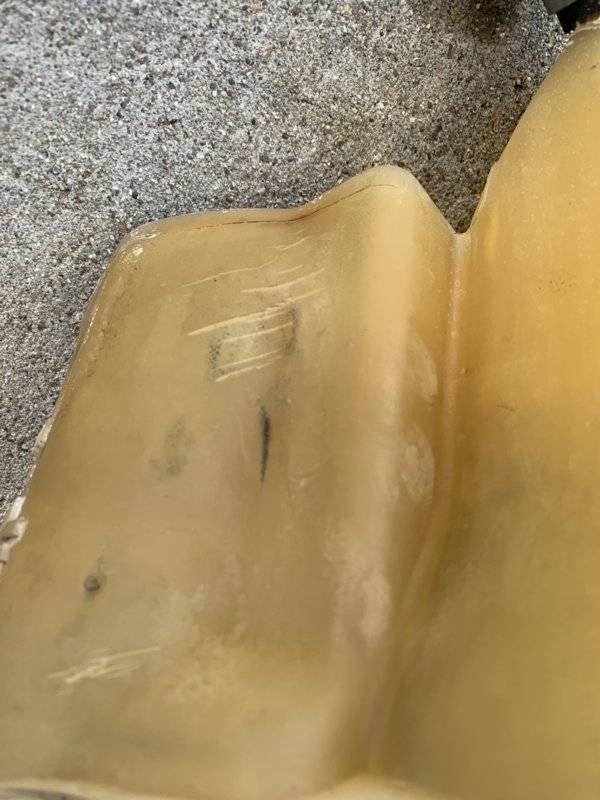

You can see the cracks on this shot. The stuff around the cap was from me spilling while filling. The bottle says “Ford” on it.
I can’t imagine an OEM bottle looking like this after 3 years.
