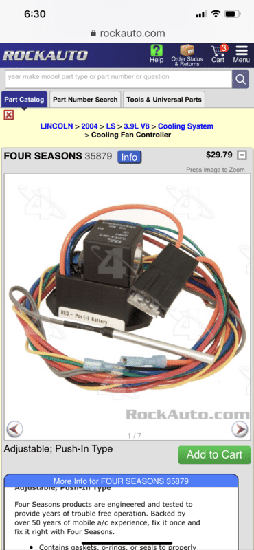

    Looking around on Rockauto, I see this “Cooling Fan Controller”. I don’t see it in the manual...what is it?

          That's an aftermarket part. To add an aftermarket fan. It doesn't replace anything factory. The fan speed controller is built into the factory fan motor. The fan control is a function of the PCM, no separate modules.
          I think your temperatures are fine. Mine are similar.
