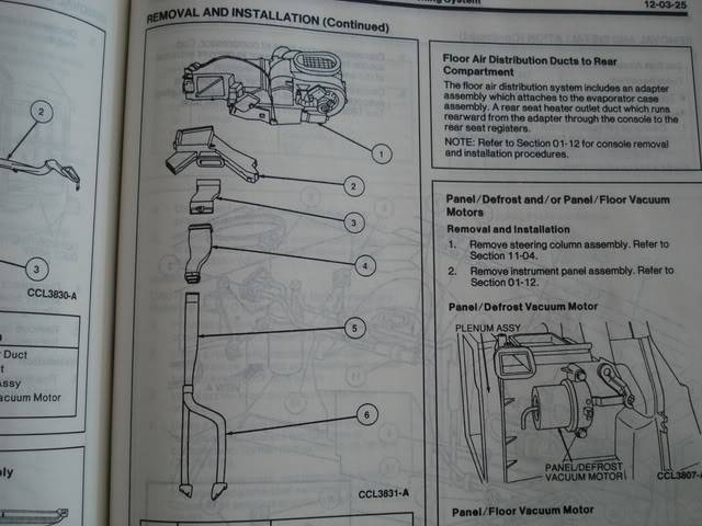

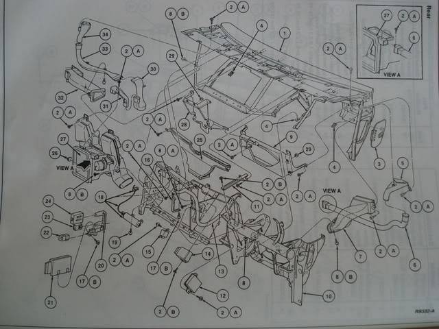

Edit: Actually, yeah, that vent splits three ways, just before the center console. Left side goes to driver's footwell, right side goes to pass. footwell and centre branches off into 2 pieces for the rear of the console.
I see where I got confused - mine never worked because those rear pipes were broken, hence I never felt a thing! lol.
You might be right... Just reading up on it now.
I do not have a service manual yet - gave mine away with the sale of my last mark - is it possible for you to post what ever diagram you are looking at so I can formulate an idea?
Sure! I don't have a scanner to hand, so I'll snap any relevant pics and post them here.
Gimme a few mins.
That was a tough site. Hardly any info at all.
Hey Medium, how do you like your car PC? Was thinking about that too.
Here we go, some relevant pics.
First is an exploded view from behind the dashboard:
Next, a view from inside with dashboard removed: (that hump in the middle is the trans tunnel with center console removed)
Next, a view of the center console pipework:
And lastly, some instruction on removing the center console: (in case you want to go in there and investigate further)
