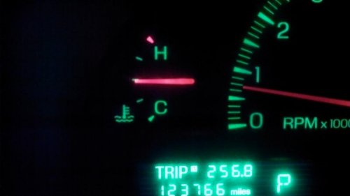

This is where my needle is after a 6 mile trip to the airport and back
It never went past the halfway point
Looks a bit higher than before
Is it fine right there

Also, the needle location pictured is fine. Anything where it's pointing relatively at the middle is normal.
Note that the highest fan speed is like a tornado.
