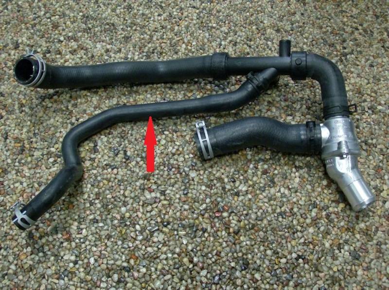

this is the hose in question:
the version of this hose I need is (I believe) 5/8in on the lower radiator side and 3/4in on the assembly side (you can see where it flares to 3/4in)
When I replaced this assembly some time ago I couldn't get the lower end of this hose off and the old hose wouldn't work because it wasn't 3/4in on the assembly side, it was only 5/8in there (the old assembly was different). So I cut it and coupled the new hose on the assembly side to the old hose on the lower side (right around where the red arrow is.
I used one of these plastic couplers:
in a few months the coupler snapped and blew out all my coolant (the day after I had a coolant flush and $30 new coolant) and the car over heated. right now I have another plastic coupler in there. But I am risking another blow out.
I was going to ask if anyone knew of any metal couplers, since I couldn't find any. But now I found this:
Dorman part#56438 (rockauto and advance auto parts)
does anyone think this metal coupler won't work?
does anyone have access to this whole hose or something similar: 5/8 flared to 3/4 and about 2 feet long?
