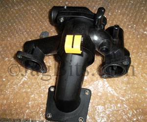

I replaced all the plastic pieces and gaskets in 2016, 20k kms (12k mi) ago, 2005 V8. I have a leak at the joint between the thermostat housing connector (the angled tube that goes to the block), p/n 2W9Z-9N499-A, and the thermostat housing, p/n 3W4Z-8548-AD. These are the Tasca item names. These are the two parts that just press together and rely on a wide gasket, and the fact each is individually bolted to the block, to keep them sealed. Is there any way to keep this joint sealed (yes, I lubricated the gasket seal with coolant when assembling). Can it be sealed better? What about disassembling and using a sealant of some sort? Just seems like this joint can't take the pressure. I noticed there's what looks like provisions for a spring-loaded wire clamp or something formed into both pieces.

That provision is for a plastic clip that Jaguar uses.
I think that it is really just a shipping thing. I can't see it making any difference with it installed.

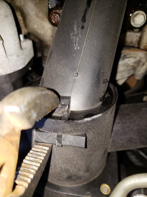

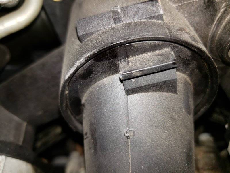

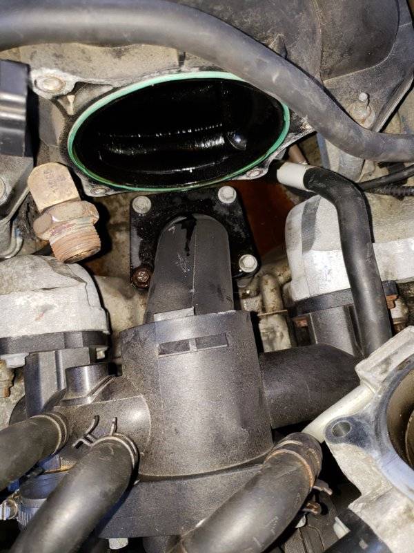

Took mine apart today and think this is another design flaw on the LS (no yellow clip).
The coolant was for sure coming out the O-ring between those to pieces. I traced it to the top of the two and realized the top doesnt fully seat like the bottom does. You can see how the top is almost flush with eachother while the bottom is pushed in.
Thinking this was my fault on install I took pliers and pressed them together and coolant gushed out while the two moved good amount just resting back the way they were incorrectly..
That plastic clip would correct this issue as nothing holds them place on top.. Is there a part number on jaguar for it? Probably a good idea to just order from them going forward if so. I dont want to risk putting another o-ring in for no reason when its just going to force itself apart under pressure.. again....
I don't know. I feel like the design is good, because it is working just fine for most of us. Maybe they changed o-ring suppliers again, and the o-rings are not quite right? Or, maybe they aren't molding the new elbow or the outlet pipes to the exactly right dimensions?

Miine appeared to be leaking from the bottom (unless it dribbled down from the top, but I don't think so). But in looking at your pic, yeah it's obvious how it's not inserted as much at the top. It would sure be nice to remove that joint in favour of some clamps and a hose.
