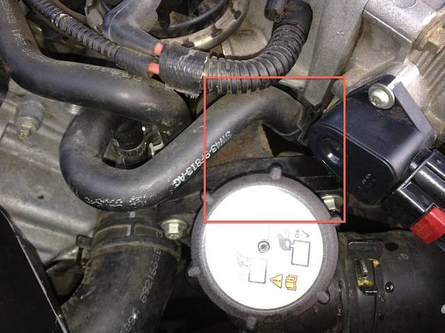

Coolant leaking again...new reservoir...now it's leaking from here.
WHY? I dunno.
Please I just need to drive to school and gym. I can't afford to have this car down...why this car keeps breaking i dont know.
every month is a new thing. alternator, struts, rims bent, battery, coolant reservoir, and gasket seals, and now this...
this is where its leaking from...it's right above the cap. Whatever that thing is, I think it may be a thermostat housing or a water pump or something. I don't know.. .please help. Why does this keep happening?

Question, is the thermostat housing what I got squared off in the picture? Because you said below, and what I got squared in the picture is above...
Physically below. It's what the cap is screwed onto. In your picture, you could say that the leak is north of the cap. Is that what you mean by above?
Looking at it now, yeah you're right. It is physically below. I was talking north of the cap as in the picture. It does sit under the cap though
