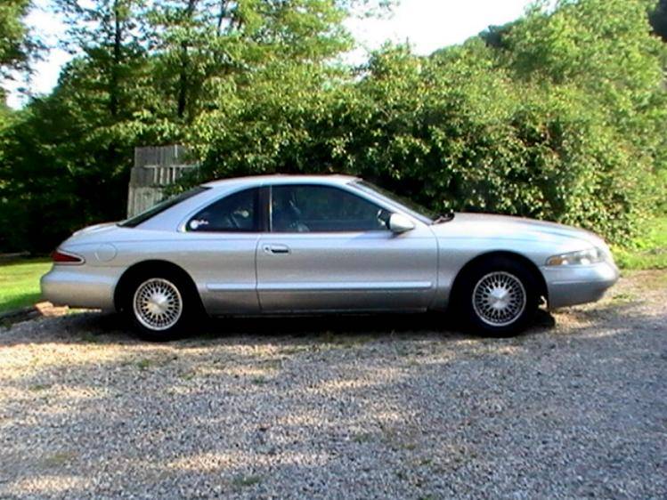

I converted my 97 LSC to coil and coil-overs today. It was stupidly simple to do, I used Monroe "QUICK STRUT"'s - middle grade of what they offered- for the front which are nice because they are assembled and ready to install... Moog rear coil's for the rear. A 1997 T-Bird V8 LX's parts are what I used from the local chain auto-parts emporium. The rear shocks have been recently replaced by the previous owner so i left them alone for now.
I made my spring perches from 10ga sheet with a 1 inch tall section of 2 3/4" dia tubing welded centered on each. A hole drilled in the center with a 1/4' allen head grade 8 bolt fed in from the top to locate the top. Wont win any car shows but they are very functional and look good in an industrial sort of way... Some spring insulators of unknown origin from the spares bin round out the package.
My only issue of the conversion came in the form of a lower shock bolt which was seized in the little sleeve on the lower control arm, which slowed up the works a bit.
I realized this conversion isn't with the ultimate in components but I think it is a step up from the "kits" I see on ebay. The ride is pretty nice- not quite as smooth as air but I'd say it is 90% of the quality- and I won't have to wonder if i will be low-rider bumping it or high-boy profiling from time to time. I left all of the air ride components installed, turned off the trunk switch, pulled the solenoids, sealed the plugs in zip-locks and tucked them out of the way in case I decided to go back.
I am pleased with the ride height, and will be nicer when the springs "settle in" just a bit. Planning on going to 17's in the near future... Sorry for the crappy photo :(

do you have any clearance issues with your taller tires and wheels on the front? I noticed that there doesn't seem to be a ton of distance to the UCA over the front tire... maybe have just been the perspective i was viewing it from tho.
No clearance issues...hub swapped with wheels fitted for a 2005+ mustang wheels
Almost 1" clearance at upper balljoints and turns from stop to stop with no rubbing
from the pic it looks like you have alot of extra room, need a closer pic. switch to 18's forget 17's tire sizes will still be within an 1" of stock.

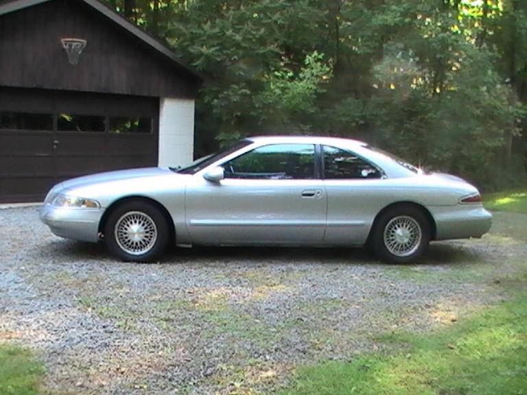

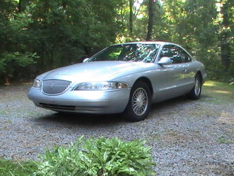

a couple of better photos- my camera really sucks...
once the springs "settle" a bit it will be sitting nicely. I don't know about 18's, I am really thinking 17's...

That's not too bad. It's still too high for my taste. But that's just me. These cars look much better when they're lower than stock. But maybe the springs will "settle" a little and it will look more like it should. That's one reason I will not switch to coil-overs unless there's no other alternative. I like having the ability to adjust my ride height any time I choose:)

It is a little high yet, I figured I will allow it to settle into where it is going to be, what wheel/tires I end up with and see how it looks.
