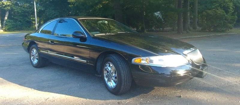

    I just bought my 97 a couple of months ago, and like you, always wanted one, looked until I bought my California garage-kept car with 89 k miles.
    I learned some lessons in a short time:
    1. Be sure it has the little windshield washer button switch on the end of the turn signal arm.
    2 that the heater works via the climate control. Problem with these cars --all Ford's-- is the blend door actuator breaks, and it's a HUGE job, upwards of $1000 to fix.
    3. No leaks in the air bags.
    I paid $4500 for mine, and have since put in another $5000. By the time I'm all done, it'll be closer to $6000. But that includes audio upgrade to Kenwood touchscreen unit, window tint, racing brake rotors and pads. What it needed was front end work, ball joints, upper/lower arms and end links for the sway bar, tensioner, pulley and serpentine belt. Plus, I had all the fluids, oil, tranny, p-steering, brake lines, and rear differential drained and replaced with Amsoil synthetics. 0916171708a.jpg
