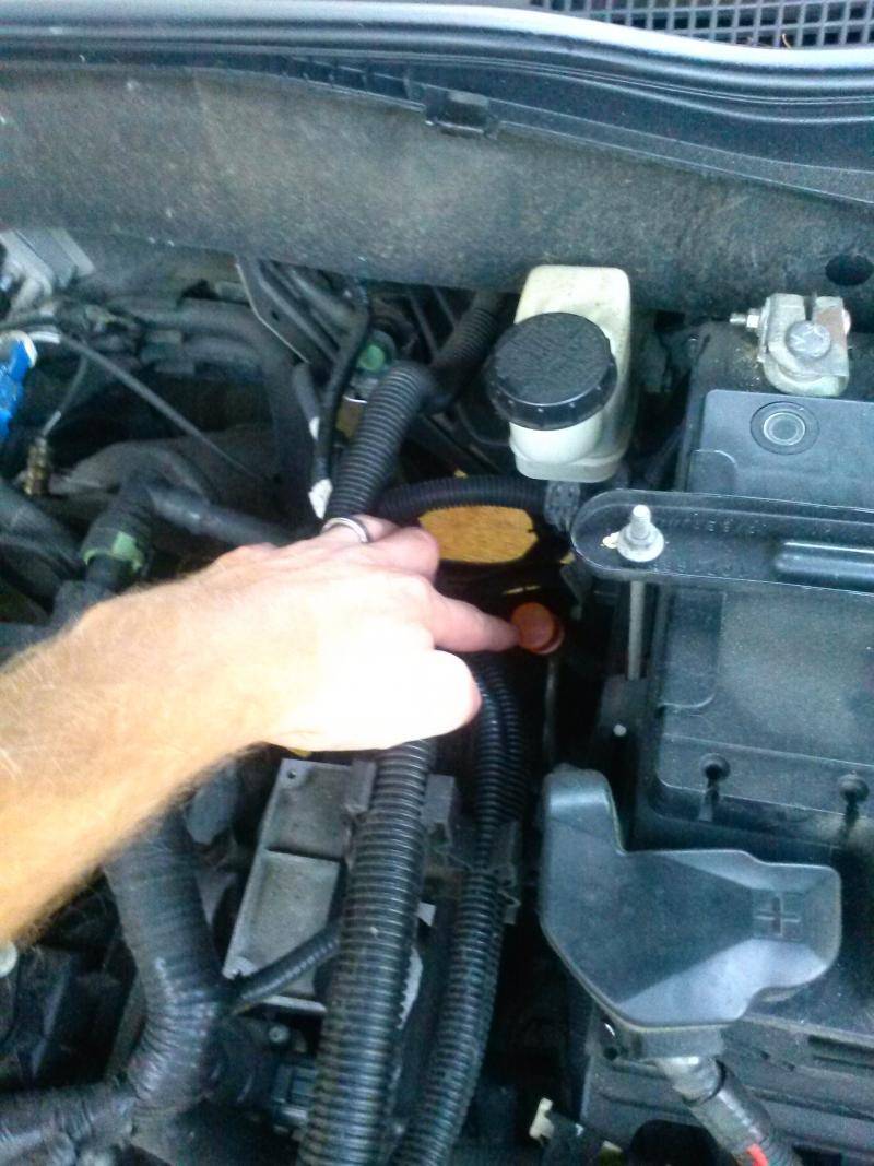

Look for a yellow-topped dipstick, like the oil. I will see what I can find.......
Thanks, please help asap. I got this dipstick that days ATF MV, which I assume means auto trans fluid. But do you add fluid to where the dipstick goes.. ?

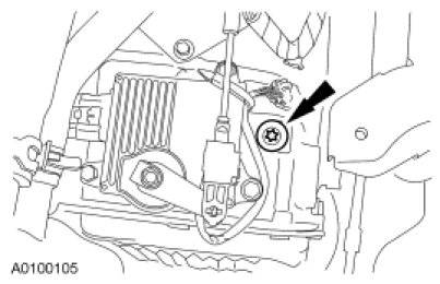

This is from a 2010 so I don't know if it will help......

On every car that I have had that had a transmission dip stick, you added the fluid where the dip stick goes.
