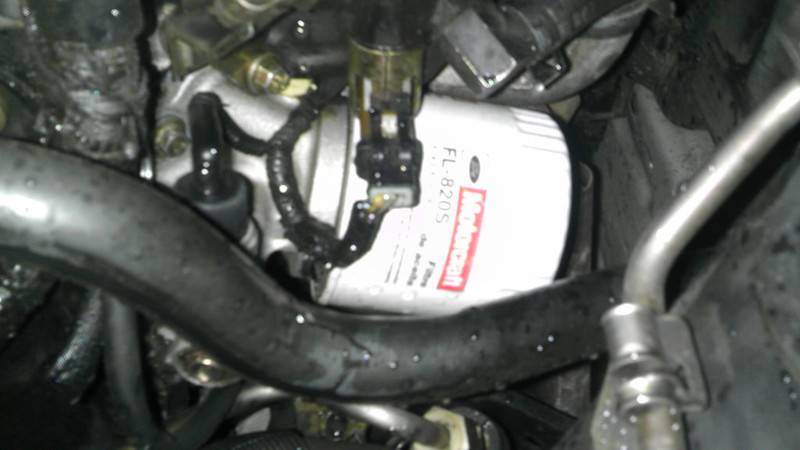

Oil pressure sending unit and the oil filter housing gasket are common for leaks.
After a oil filter change its normal for residual oil to drip for awhile.

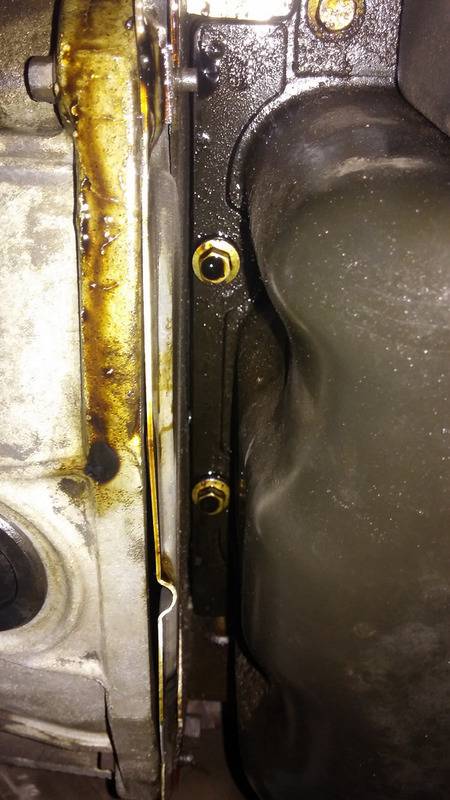

I have had to replace the oil filter adapter gasket and oil pressure sender, I still have an oil leak from the pan gasket, on the passenger rear (so I don't think it is leaking from any place else).

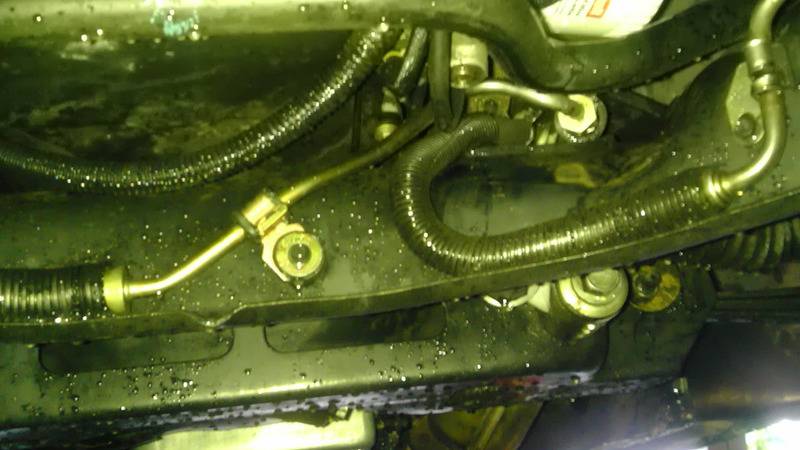

At least the Mark VIIIs have the dimple on the K member to sorta drain oil off of it. My 89 Cougar does NOT and it holds enough oil to be messy. Can't just soak it all up because of the corrugated plastic covered power steering hose there. I generally power wash it after an oil change.
I would find this after parking for a couple of days:
replaced and cleaned up and it never gets too bad now:
curse you k member but at least that spout to drain some oil exists:
current oily spot:
looks like the hump has split, but I don't think it has, but it is oily:

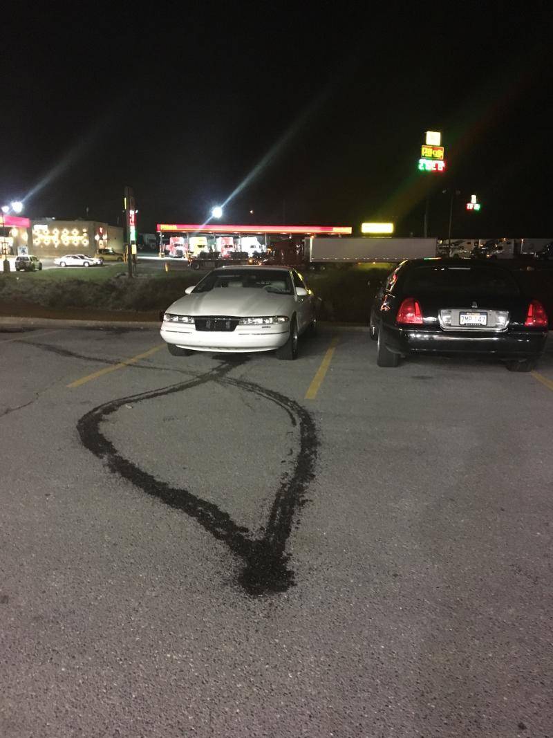

THIS is an oil leak!
I had it towed back to the garage and the next morning found this...

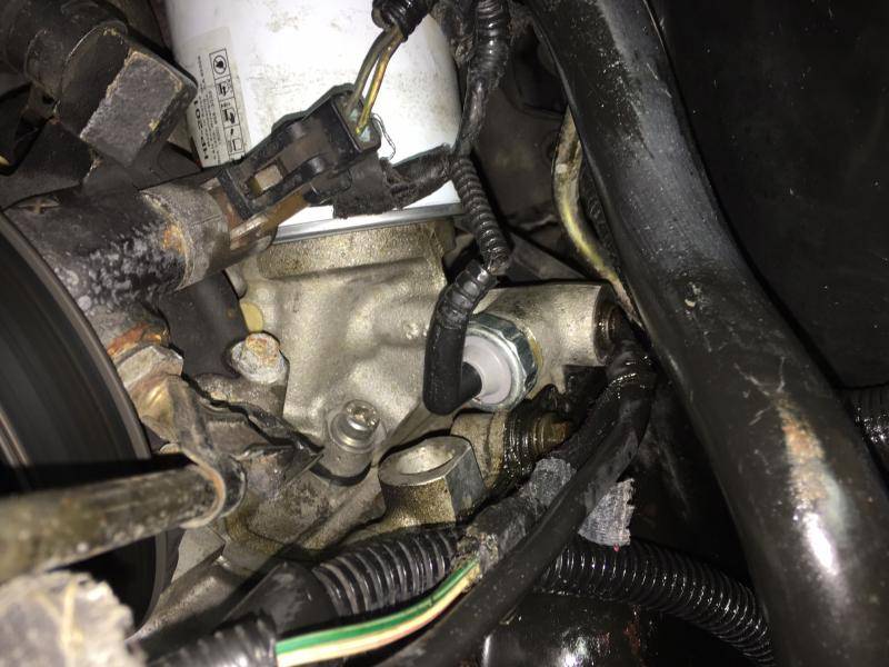

Replaced it with a generic parts store unit and it is all good. :)

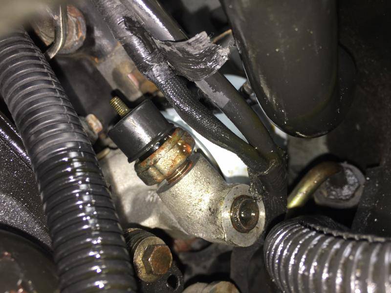

I had my oil pressure sending unit blow out in a drive thru. Not good. It was a cheap one about 6 months old, replaced with an OEM unit.
I plan to replace it with a MotorCraft unit.
I was on my way to Atlanta when I had this happen. I had it towed back home and fixed it in time to still make the trip albeit behind schedule.

I've had both leaks, the adapter gives you some warning but the oil sender unit could be catastrophic-Mine went about a year and an half ago, I had just left home and had driven it in stop and go traffic, and about 2 miles from home, i looked in the rear view mirror (lucky no cars behind me) and saw a heavy puddle as I pulled away from a light and a trail of oil leading from it-I opened the door and leaned out and looked under and it looked like a severed artery-pumping out big time. Shut it down right there and got it towed, the sender unit just let go with no warning. I went to the ford dealer and got one for $27, but when I installed it I got low oil pressure light (no noises thought)-I went to Advance and got a sender for $7, installed it, no more light...took the Ford unit back and got a refund. Weird.
