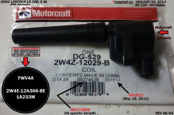

...I'm inserting a pic of what/where ordered, BUT, I don't kow if $price is currently the same, what I bought them for $39.95.
...You'll notice the ad is titled w/ DG-515 , but detailed specs is described as DG-529. In the end what I received was DG-529.
