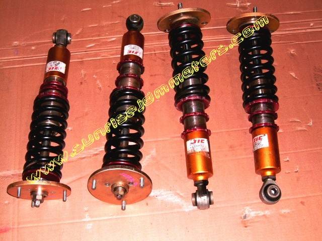

1st pic is the Tein Super Street coilovers for a Lexus

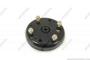

2nd pic is random supra coilover pic showing the 3 stud top plate of the majority of $600 coilovers. Yet the bottom of the coilover mount is an eye mount just like the LS.

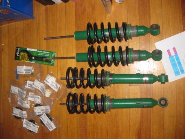

3rd (the small pic) is the stock Lincoln top plate
internet research has shown me that any coilover with an "eye" bottom should be adaptable. But if we find a coilover with the bottom eye mount all we need is someone who can fab a top mount. LS uses a 4 stud top plate while most other vehicle shocks use a 3 stud.
The Tein ss do not come with a top plate when you buy them. so in theory someone could buy the Teins' then use the stock lincoln top plate.
questions are: Will the stock lincoln top plate fit the coilover springs of the Tein SS?
Can someone fabricate a top plate that is adaptable for the LS using the $600 coilover parts?
Tein SS retail for $1100. The $600 ebay coilovers from different manufacturers for many diff cars only come in the 3 stud top plate which wont fit the LS shock towers......unless someone drills new holes in their shock tower to fit the 3 stud top plate. from what ive seen the LS shock towers where the studs go through aren' t really reinforced so maybe drilling new holes wont be a bad idea??? Or drill holes then fab a reinforcement plate like older BMWs have.....?
