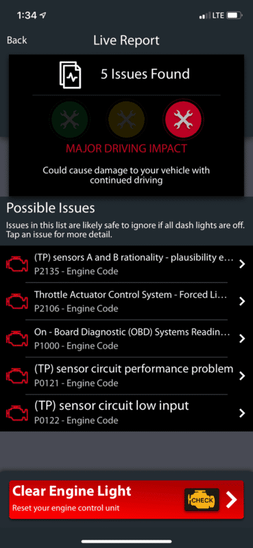

Replaced the thermostat parts, turned the car on and it went straight to limp mode and check engine light was on, buddy scanned and these codes came up.....
P1235 Fuel Pump Control out of range ...This could be triggering all the rest...Try disconnecting the battery for 15 minutes and reconnect ...it might allow the Fuel Pump to reset itself back to Factory Specifications ...I had to do this once when I changed out my Fuel Pump assembly
Please note that he posted P2135, not P1235. You are leading him way off in the wrong direction. His throttle body is not properly electrically connected. The locking tabs on the connector break very easily.

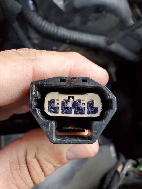

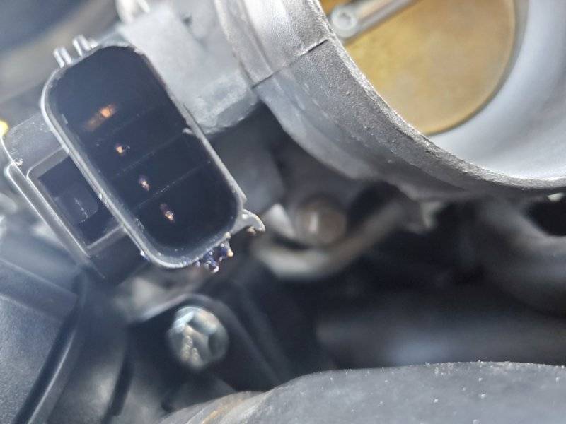

So everything seems to be connected, posted some pix, that is the parts I replaced, I unplugged the mass airflow sensor while it was running seemed to sound better when it was unplugged, could the sensor be dirty??
Something doesn't look right inside the connector on the throttle body.
I see 3 pins... and a shiny spot at the one to the upper left... like that pin is broken off.
Look closely at the first pic you posted.
....... yup... after a 2nd look... that top pin is broken and folded down.
You are gonna have to replace your Throttle Position Sensor.
That can be a bit tricky... because the screws will sometimes snap off... causing bigger problems.
Sometimes carefully heating up the throttle body will help get the screws out... but it is best to remove the whole throttle body to do that.
If this is getting beyond your skill level... or you are uncomfortable doing this... it might be best to contact a knowledgeable mechanic buddy.
That top pin IS broken... correct??? It's kinda hard to be positive by the pic.
The plug looks ok though.
Definitely looks like its bent back, I soon as I saw it, it didnt look right, I've heard about having to heat the part up to get the screws out

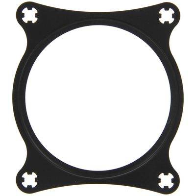

front or rear gasket
There's only the one, no front or rear. He's talking about the gasket between the intake manifold and the throttle body adapter. I've reused mine without trouble, but it's not a bad idea. However, he's wrong that they have to "pull the throttle body." I haven't the last time or three. To me, it's easier to remove the intake manifold, leaving the throttle body attached. If they go that way, then you will need new intake manifold gaskets (2, left and right side).
Actually... I'm talking about the front gasket. The one between the throttle body and the throttle body adapter.
Maybe I'm missing something Joe... or maybe you misread something... but I see no reason to pull the intake, in order to pull the throttle body off the engine to replace the TPS??? o_O
